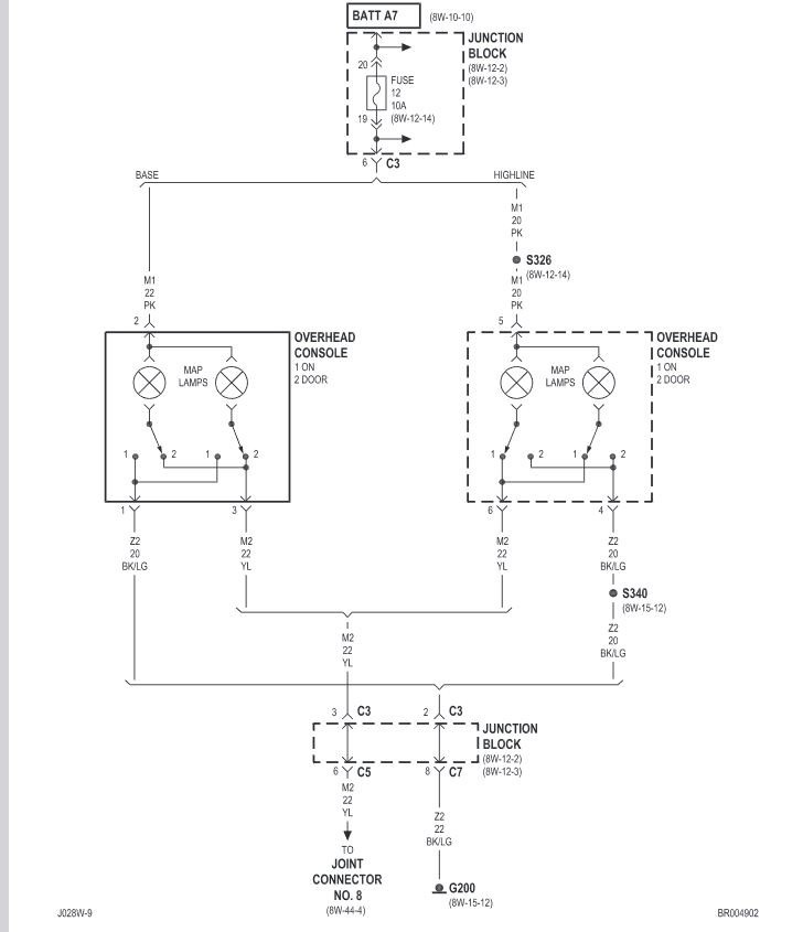

It does have the map lights however, and that also brings up an interesting point - the map lights work when turned on individually, but do not turn on with a door open. IIRC, when a door is open those map lights turn on along with the dome light. Sooo, those lights must have 2 sources of power and one is still working.
You might be on to something here. The map lights have the SAME source of power (Fuse 12 in the Junction Block), BUT they have two separate grounds. When the map light switch is activated, ground G200 is used. When map light switch is deactivated and the door is opened, a different ground path is used. This same ground path is used to turn on the dome light (also Fuse 12) when the door is opened. The door switch ground path may involve the Central Timer Module - not sure.

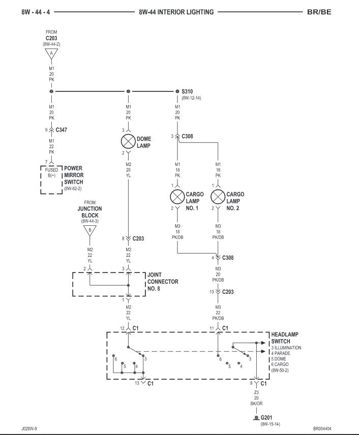

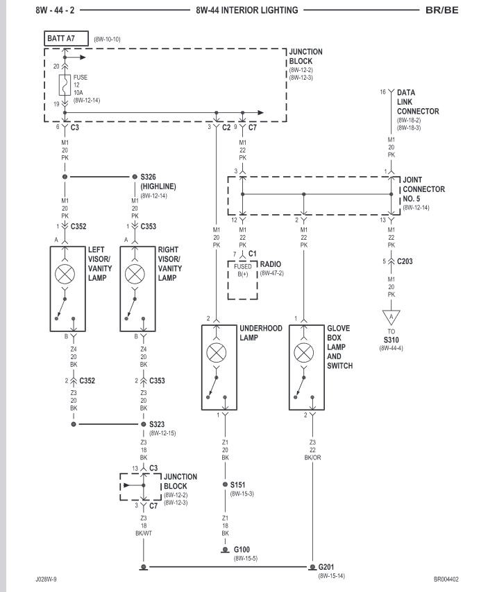

Dome light, cargo light, power mirror, radio - all get their power through Joint Connector #5 which is downstream of Fuse 12.
Dome light, cargo light, and power mirror get their power from Pin #13 of Joint Connector #5. The power continues through Connector 203, then Splice 310.
Start with the upper diagram and follow Connector 203 with the letter "A" inside the triangle. Pick up the same connector in the lower diagram.
I think part of your problem exists either in the wiring or connections including Joint Connector #5 through C203 and arriving at S310. Note that the power for the underhood light and glove box light (which are both working) come from the Junction Block and Joint Connector #5 respectively. They both have separate grounds as well.

Power mirrors - INOP - Fuse 13 - Also Feeds CTM B+ (12vdc)
Dome light - INOP - Possible routing through CTM - Still researching
Map lights - INOP with door open, works when switched individually - Individual switching via direct ground circuit. Possible routing through CTM - Still researching
Cargo lights - INOP - JB Fuse 12 - G300 - Dome, Cargo, Glove Box, Under Hood, Overhead Console, Power Mirror, Radio, Data Link Connector.
Dome and Cargo Possible routing through CTM - Still researching
Underhood light - ops normal
Glove box light - ops normal
Radio - comes on but no sound. Suspect amps built into each speaker unpowered. - Possible routing through CTM - Still researching.
