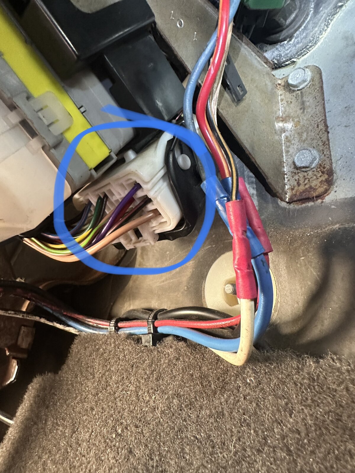

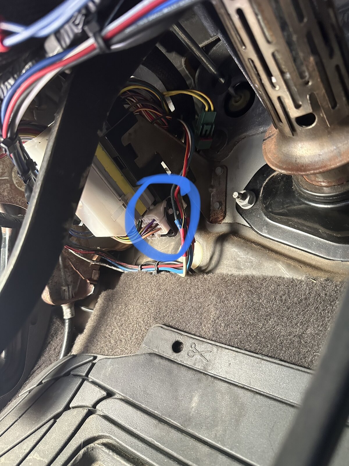

All along I thought there was a good chance this was something simple. The problem ends up being with so many places to look, it’s like finding a needle in a haystack! I finally decided it was time to start taking things apart and just look for obvious problems like broken or chafed wires, loose connections, etc. An obvious place to start was the CTM or back of the JB. Took off the panel below the steering column and started looking around, almost immediately saw this cannon plug partially out. Snapped it back into place, immediately noticed the dome light and map lights on! Checked other items - all working. It does appear that the locking mechanism (the black bracket on the bottom) is broken and not engaging properly allowing the plug to just work its way out over time.

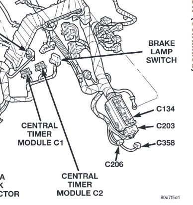

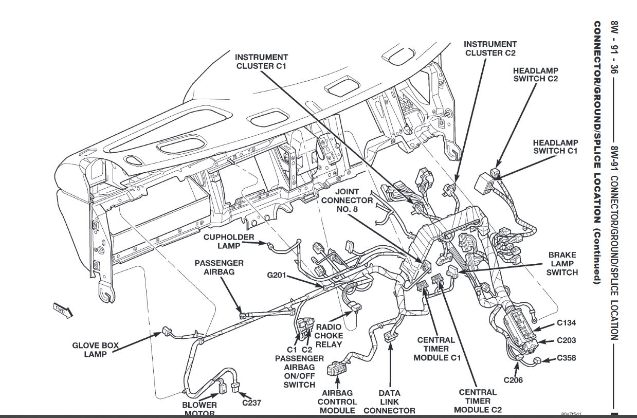

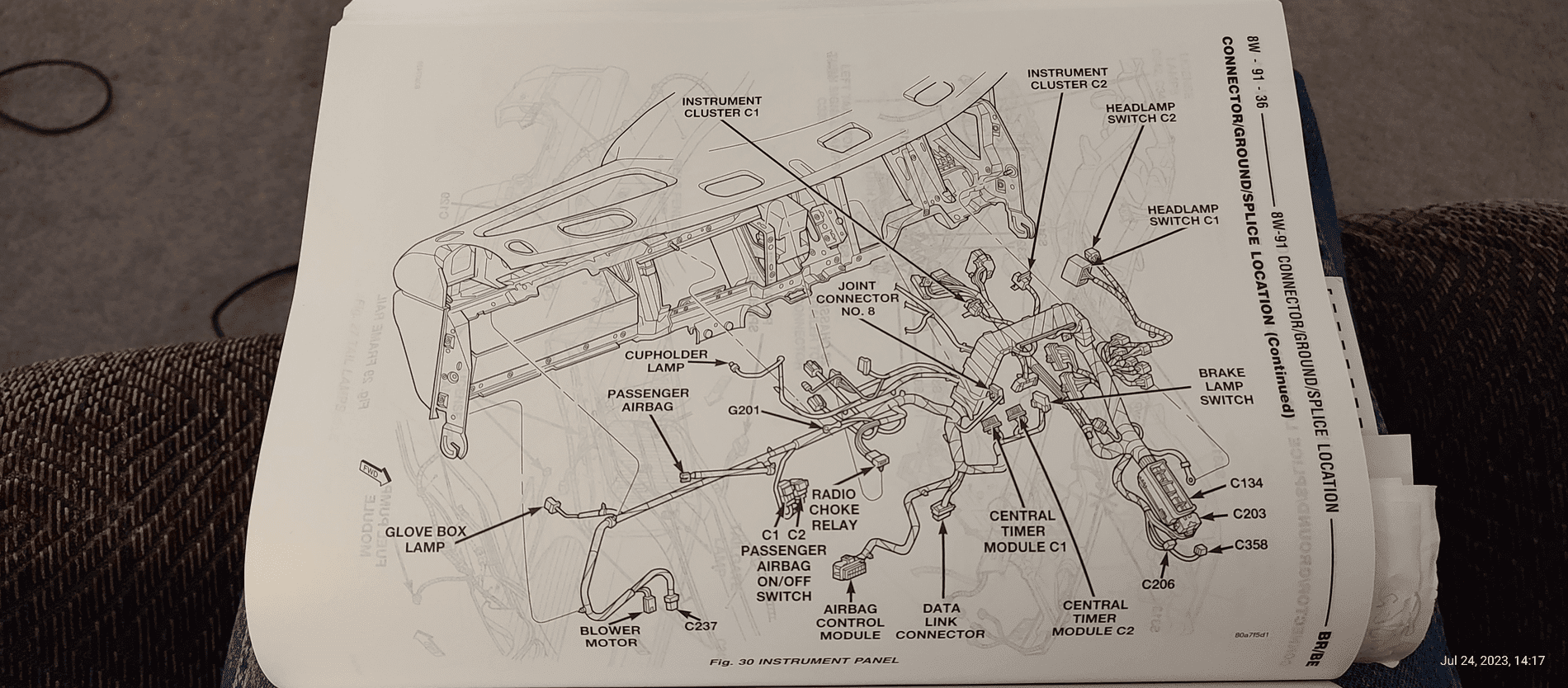

So here’s a question I still have for future reference. Let’s say using the diagrams and mapping things out, you come to the conclusion that C203 for example is a common point and you want to check that out. You can see it on the diagrams, but how do you determine where C203 is physically located on the vehicle? I’m sure there must be somewhere in the FSM where it has a list of connectors and their locations, but I haven’t found it!
Yes. There is a section devoted to location as well as connector pinouts, factory splices and ground points, etc..
In the 2002 book they are located after the schematics. Starting at 8W-70-1 for splices, 8W-80-1 for Connector pinouts, etc..
Bruce, click on "8W Wiring" in the Table of Contents. Then select "Connector/Ground/Splice Location". That will take you to 8W-91-1. From there you can find C203 (Fig. 30) or any other connector, ground, or splice.

This picture is to answer to RDMueller's question.
Oh the challenges to get a photo posted...
Here's an example showing the picture of the C203 location (lower right) along with all the bookmarks...
View attachment 137802 View attachment 137801

No, it is snapped into place and locked properly now. I probably didn’t get it locked after the last time I had the dash out.
It has a cam-lock lever to pull it tight and a locking tab on the lever. Somebody had to try to not fully connect that one at one time or other.
Yeah, that must be the black part. I think last time I put it together after having the dash out, I didn’t fully understand how to properly lock it. Those connectors always seem to give me fits, mainly getting them apart because it seems like every one is a slightly different design and you are usually working in tight quarters and can hardly see what you are doing. But I’m sure I have it right now!
