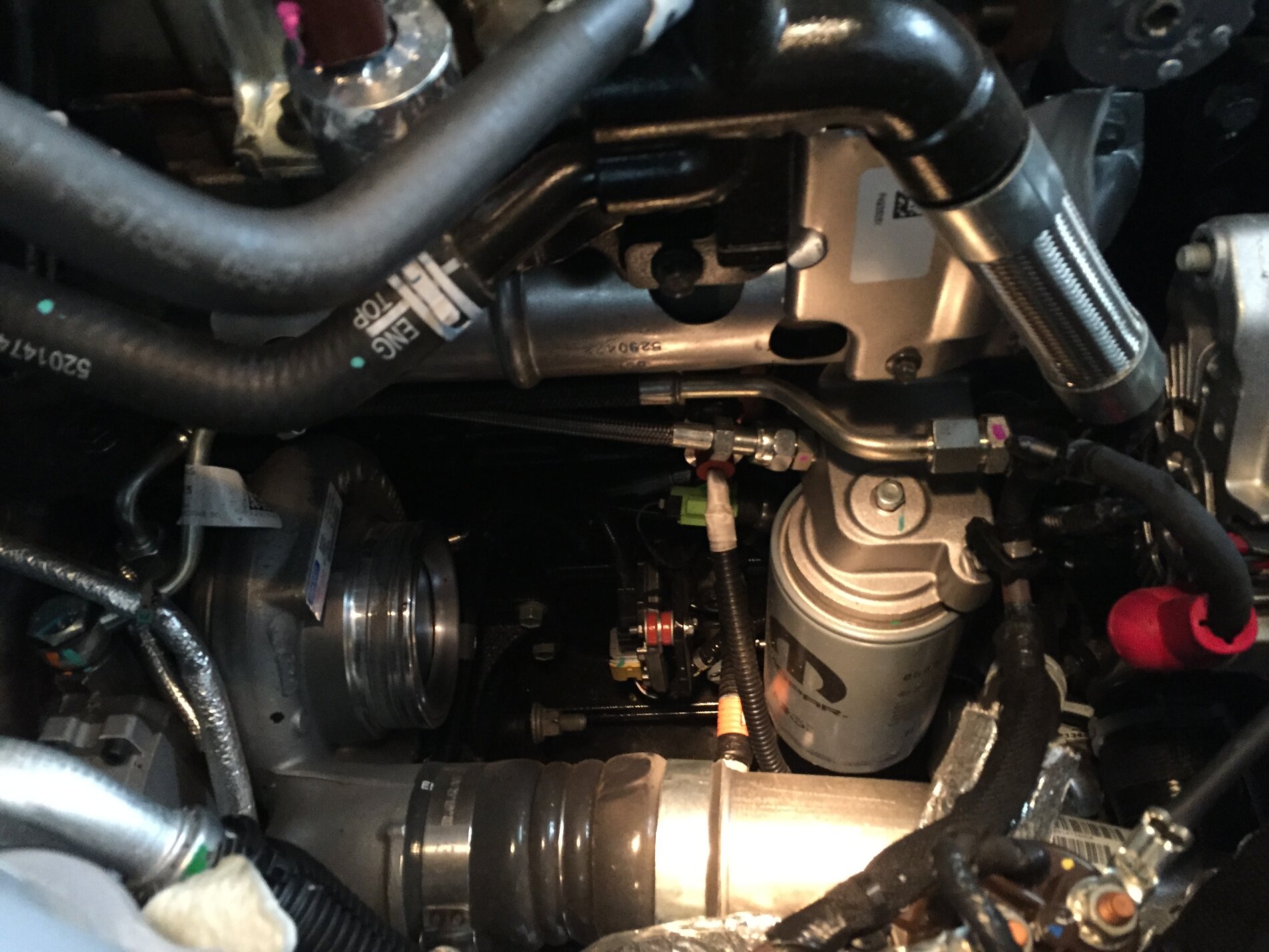

This is how mine came from the factory.
This is what it looks like from the top. To me it’s a no brainer.

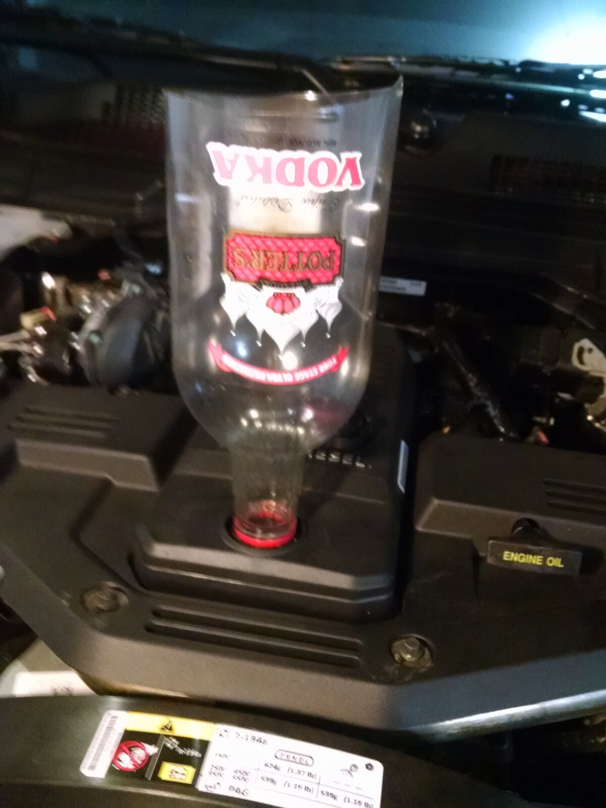

To add a little new juice to the thread, this is how I added the new oil. Screwed right into the valve cover. Made it really easy to pour 3 full one gallon jugs of oil in. Well really part one of the jugs when in the filter, before I lowered it in, put my left hand under the bottom of the filter and turned it in place with my right hand.

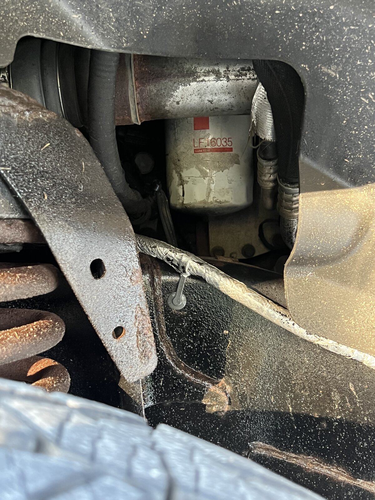

That’s actually Fluid Film and road grime. I spray the underside of the truck twice a year with Fluid Film.
Good man, now I see it too on the spring bracket. You care for your investment, that's awesome. It's so sad to see these beautiful trucks rust away in just a couple years.
I try my best will all our stuff, but living in the Rust Belt it’s hard to keep up sometimes.
