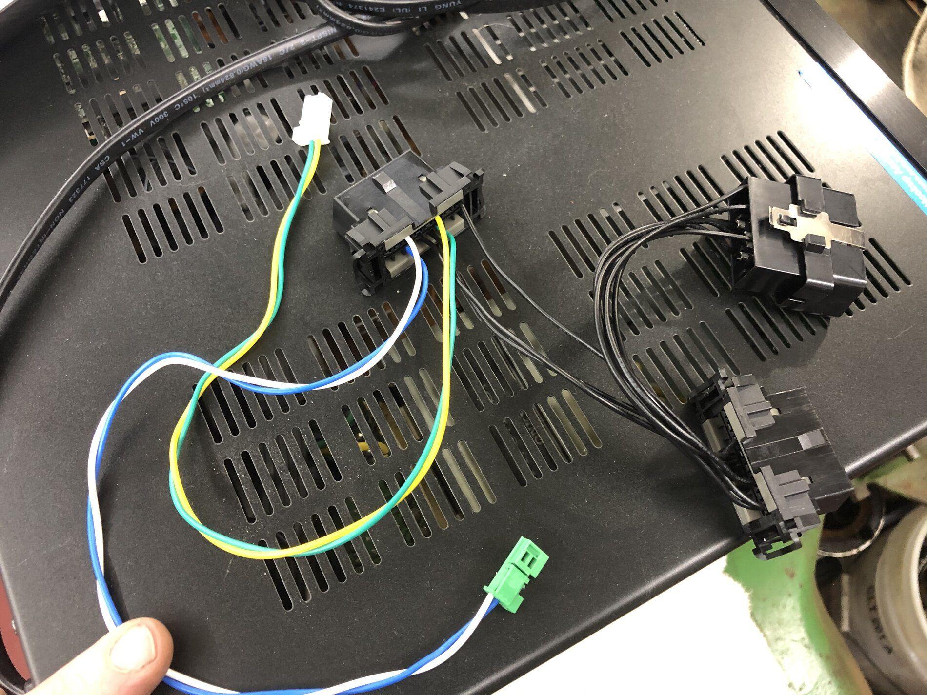

My harness is completely different. It also has a secondary port for more devices to be plugged in. I assumed one goes to the existing port leaving one to be mounted in the original mounting spot and another is “floating” behind the knee bolster. The blue and green harness plugs are what I’m confused about. The have plugs, not pins for a connector.
It is a very different setup.
The smaller plugs go into the green strip. From what I have been able to find it doesn’t matter where on the green strip they plug in. Does that harness replace the existing OBD port altogether?
I don’t believe so. In essence this harness just supplements the existing with no modifications. Plug and play. At least how I understand it. But then again, I don’t really have any documentation to prove one way or the other.
I followed a link to Z Automotive posted here by another member.
The green and white connectors plug into the interior and high speed star connectors. The star connectors are just BUS bars that connect all the modules together. Plug them into any open cavity. As mentioned they bypass the SGM.

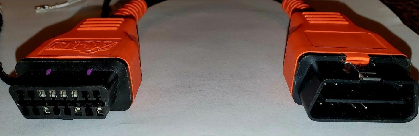

The harness you have appears to allow two scan tools to be connected, one bypassing the security module and the other passing through it.

Very nice harness, not worth DIY at the price point I paid nor can most replicate the nice moulded ends. This security bypass was like $25.

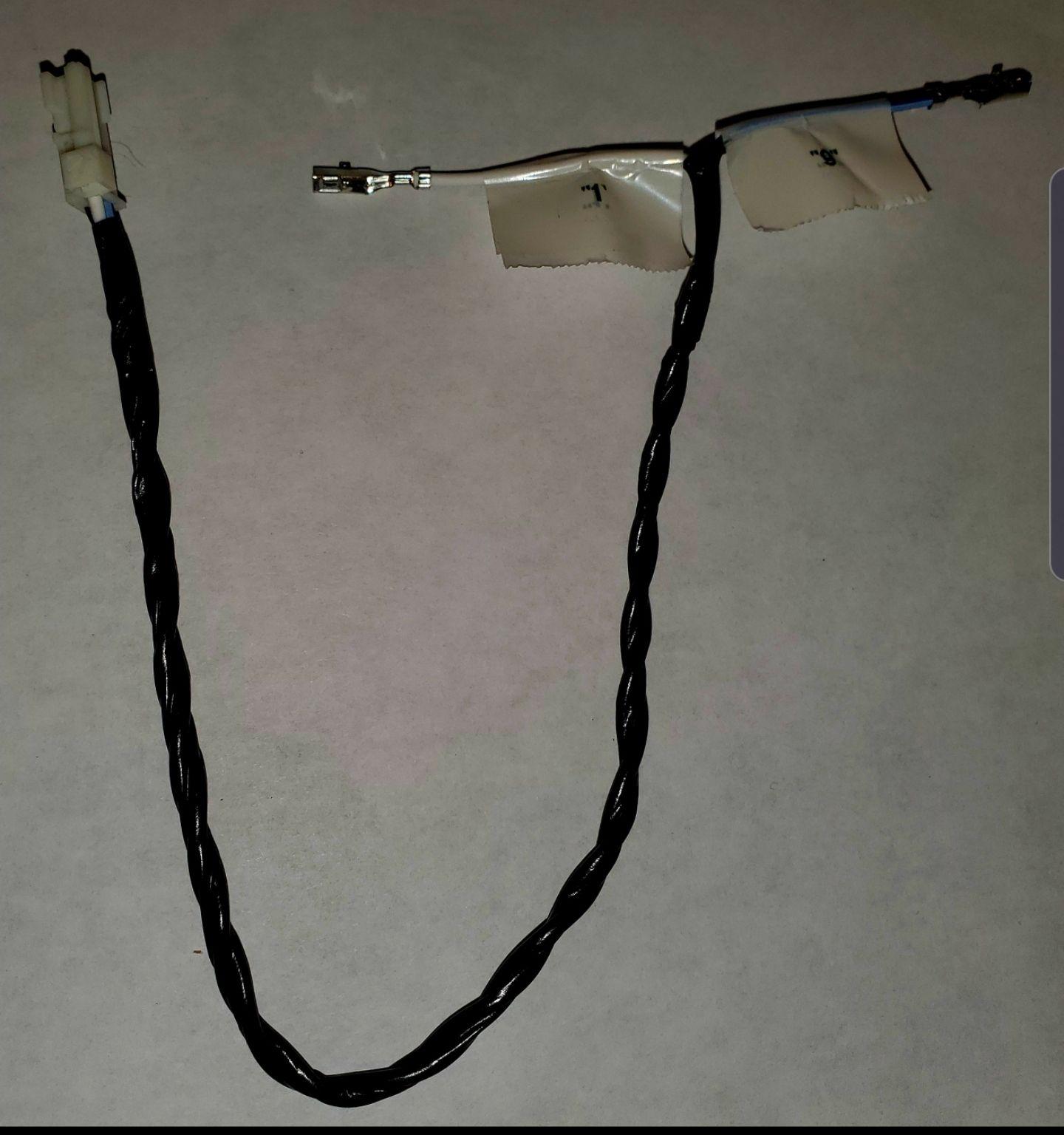

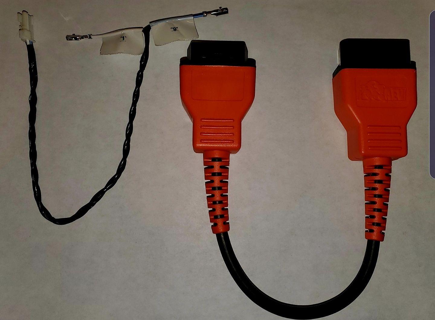

That is the entirety of the hardware that I used. Just need the RFHub PIN and the AlfaOBD app and have fun.
