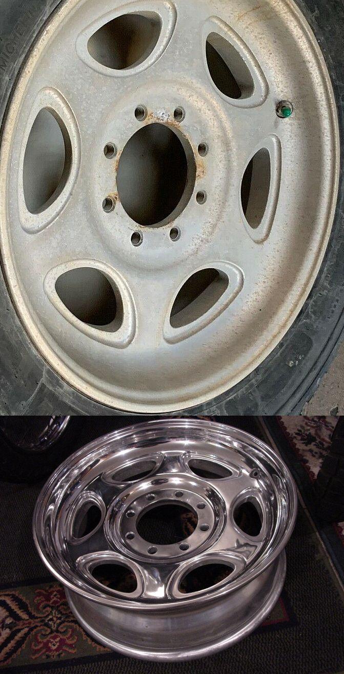

Looks GREAT...Now that you are done, can you please come over here and polish my Rickson forged aluminum wheels ?? LOL
I guessed at about 4hrs labor on each wheel....( and a lot of polish/ sanding material $$ )

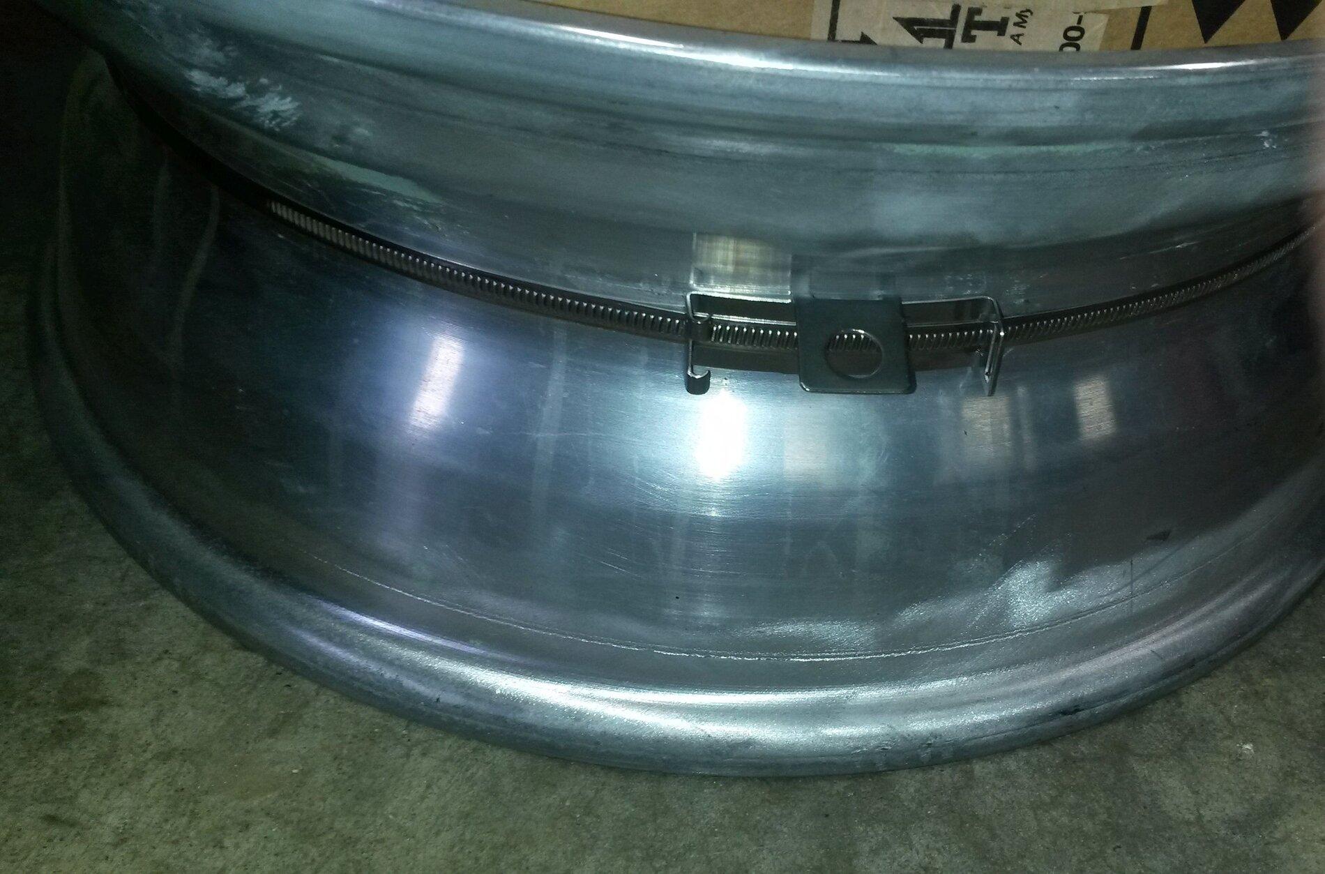

Heres what I found out, this only pertains to a 2017 SRW 3500 pickup . After breaking the bead of the tire, we stuck the activator tool into it . It activated the sensor. We reinstalled the 19.5" wheel/tire combo, on the truck and within about 15 minutes of driving the truck read the sensor! I would call that a success , however the system maxes out at 101psi, and after a long talk with a tire pressure engineer, we think its the trucks electronics not the sensors. But I still consider it a success because the display on the trucks dash will still show an pressure loss under 101lbs, that will give me a fair warning and most likely I will never have to go over 110lbs even with a load safety margin.
So heres what I think ;the sensor activator tool the tire installer was using did not have enough signal strength through the thick Toyos until we stuck it inside but the trucks receiver does.
newest update, after about 10 hrs in a recent 14hr trip my right rear sensor winked out. Everything was working great up to that, including other trips. Pulled over and checked tire pressure with no change. Drove some more and it started reading . Few more miles it went off again, and I timed it. At about 7-10 minutes it started reading again, then in about another hour my right front went out, and started reading pressure again in about the same amount of time. Taking it to the shop Weds. Either the sensor batteries are going bad at about 2 yrs old , or the band system got loose and the sensors are bouncing around inside( unlikely) . Or?

Had another talk with an TPMS engineer. He added that the sensors are normally mounted in the valve stem holes, therefore they are always pointing out . That orientation is used along with other things to compute the sensors location. If the one or more sensors were mounted with the bands I needed to use were pointed towards the center of the truck , that also could confuse the trucks computer.
