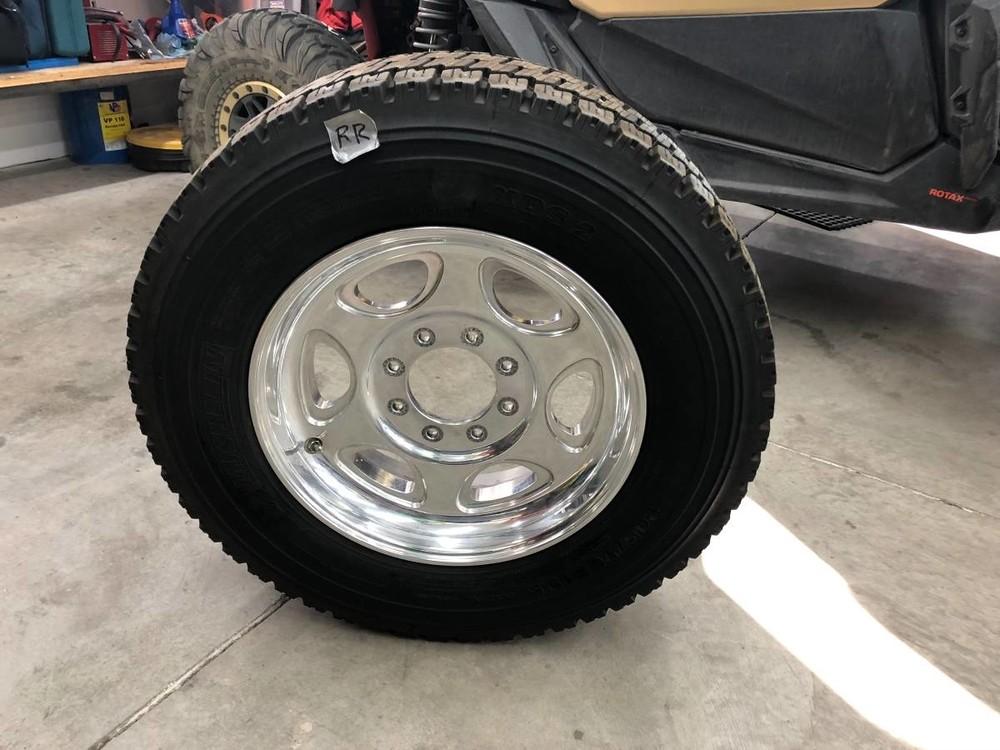

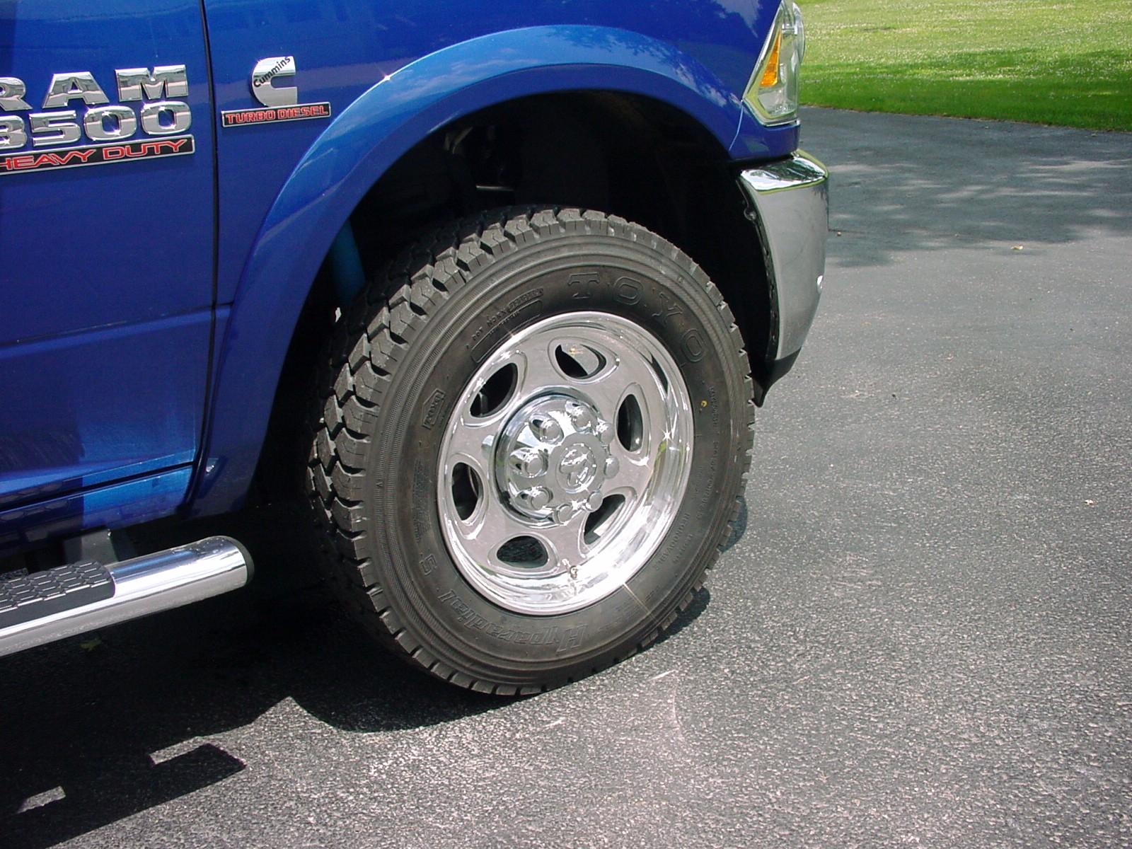

Heres what I found out, this only pertains to a 2017 SRW 3500 pickup . After breaking the bead of the tire, we stuck the activator tool into it . It activated the sensor. We reinstalled the 19.5" wheel/tire combo, on the truck and within about 15 minutes of driving the truck read the sensor! I would call that a success , however the system maxes out at 101psi, and after a long talk with a tire pressure engineer, we think its the trucks electronics not the sensors. But I still consider it a success because the display on the trucks dash will still show an pressure loss under 101lbs, that will give me a fair warning and most likely I will never have to go over 110lbs even with a load safety margin.
So heres what I think ;the sensor activator tool the tire installer was using did not have enough signal strength through the thick Toyos until we stuck it inside but the trucks receiver does.

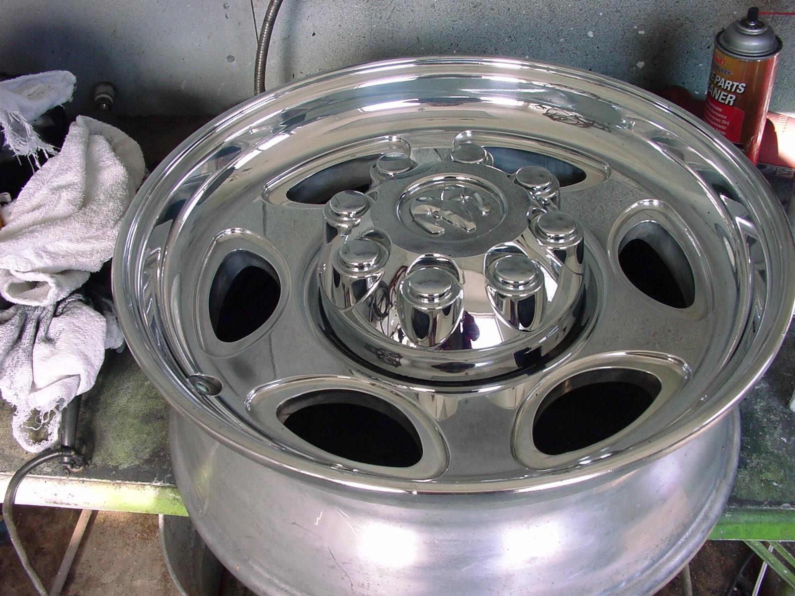

Update on the rig ; forged polished aluminum 19.5" Ricksons with 245 Toyos. I installed the Centramatics I had for the steel Ricksons . Now the wheels/tires are dead smooth. Good! And the Centramatics do not interfere with the tire pressure monitors, more good news! :):):):)
