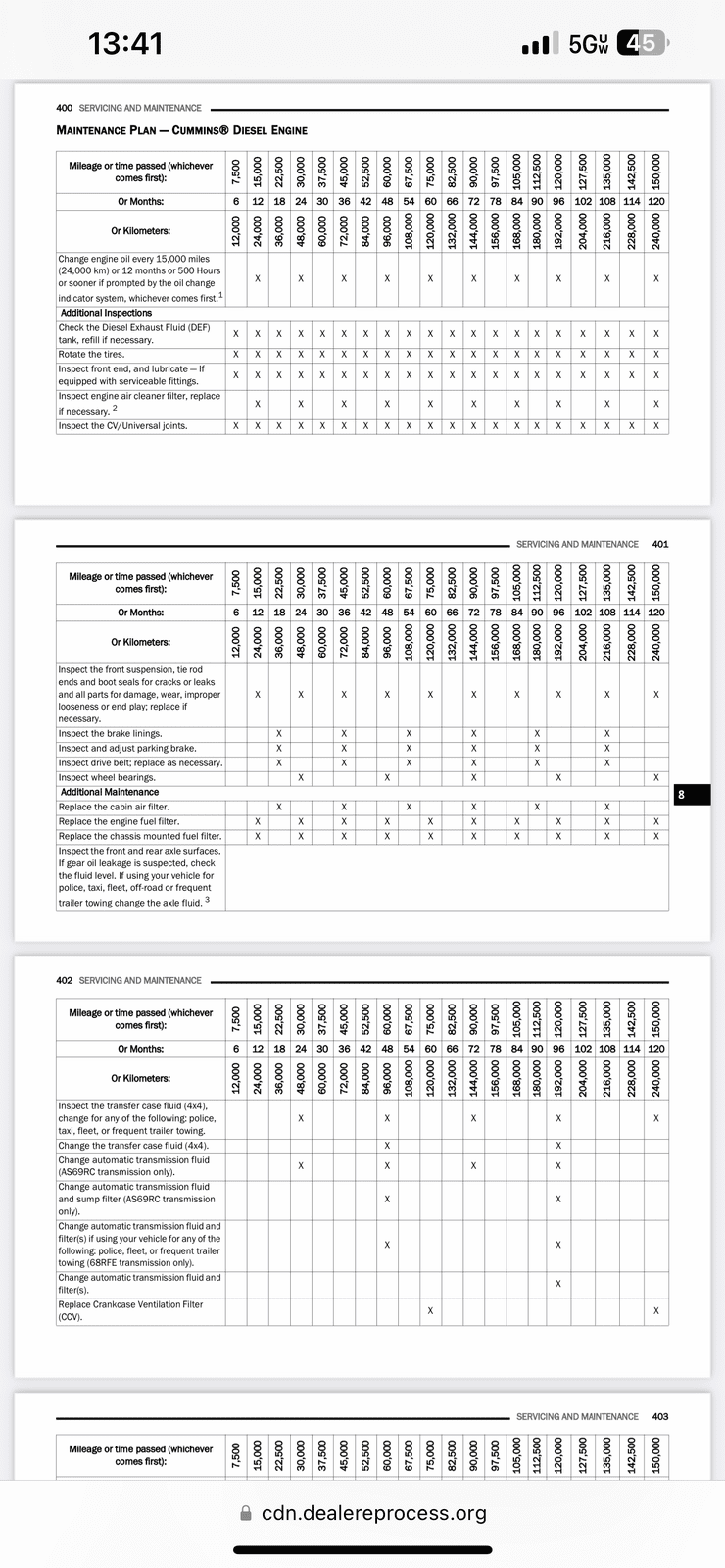

I don't see anything about time for the transmissions, either one, just miles. Maybe the '21 book is different than '22?
Funny I didnt see it either.. but when I went back and double checked sure enough it was there... 24 mo / 30k miles... I did mine this year.. about 29 mo.. but I only saw the 30k miles and oh well... fluid was clean.. amsoil went in and its checked off... I guess I'll have to do it again next year to be on that "48 mo cycle.....
After my warranty is over another 6 years and 40 k. I think I will go to much longer change intervals and do miles instead of time. I drove it a lot the last two years because it was new. You always play with the new toys the most right.I will be 80 by then still hope I’m here to drive and can drive. Only way this truck will get wore out if someone else buys it
This is the 2021 manual, reads the same as the 2022 and the 2018 I had. Every service interval has a months and a miles, it’s whichever comes first.
