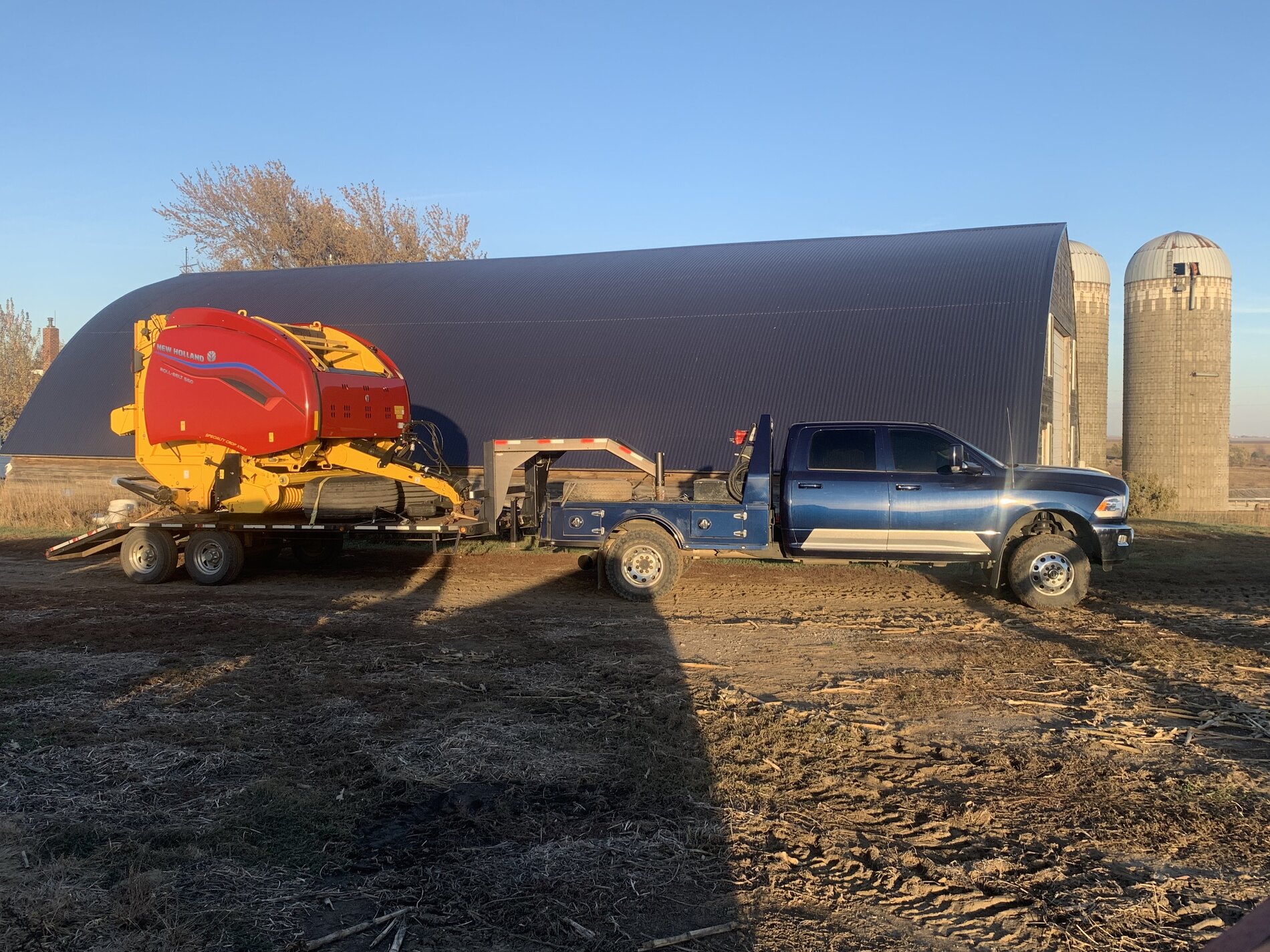

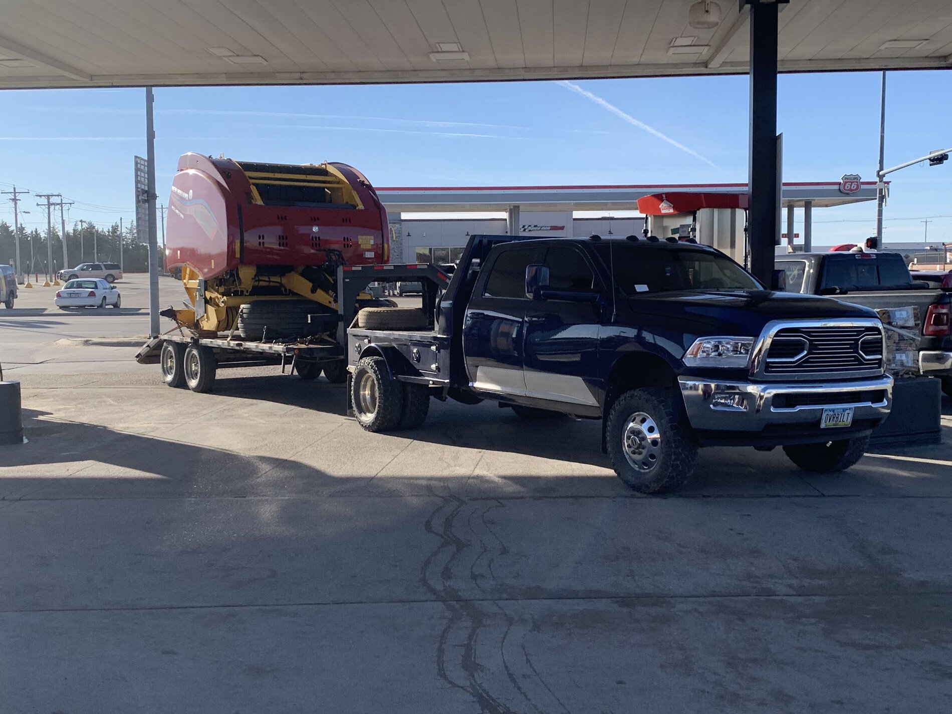

Pictures of my nephew’s truck, my trailer and load. 250 mi one way run. Truck handled the trailer and load easily; however, running loaded in 6th gear produced a head splitting drone for the front seat passenger so I was forced to run 5th when loaded. Otherwise it was really quiet in the cab, lot better than my ‘99 Cummins. 6C21B412-5887-4D14-885A-A96E8313A626.jpegD99450EC-AED3-4C51-808F-13D952DFB16C.jpeg
