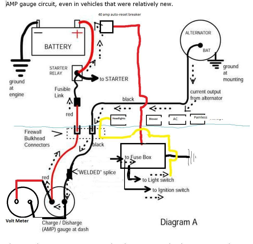

By the time I break out the separate battery feeds, the only components left in series are the battery, the alternator, and the ammeter. the voltmeter and the other battery legs will be on parallel. I could see the charging/ discharging status of the battery.
What do y'all think about this configuration?

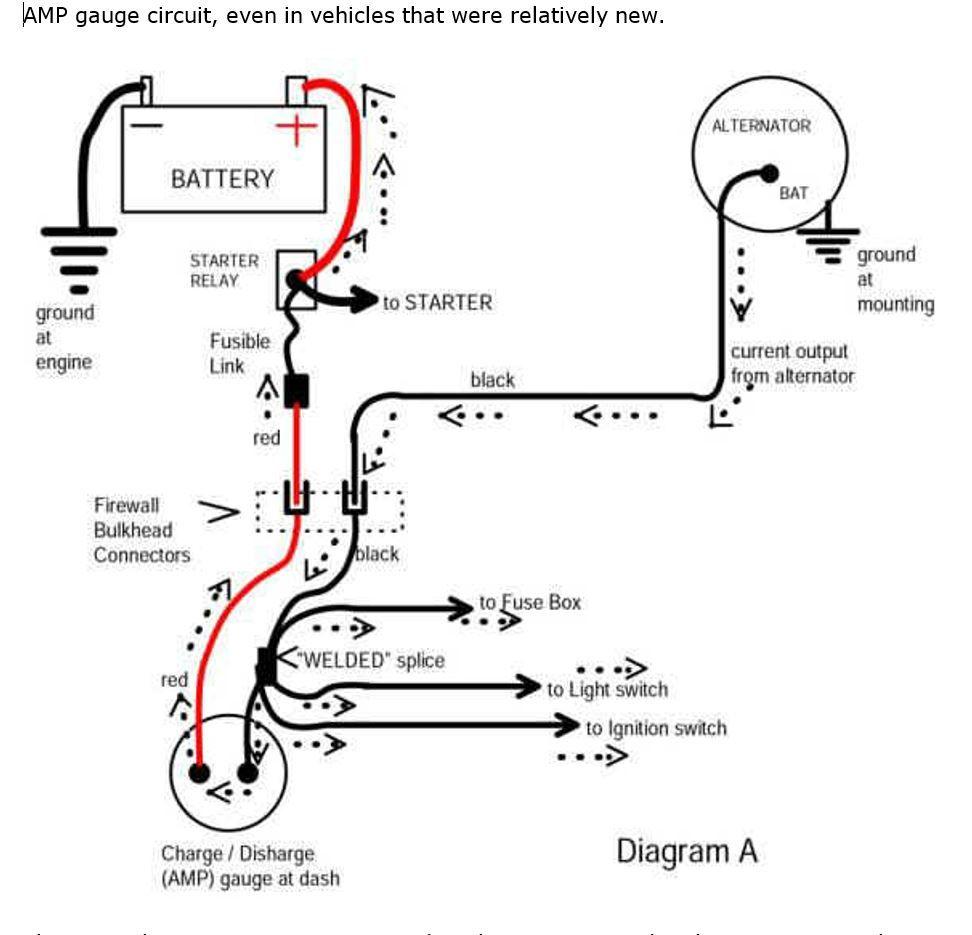

EDIT: I haven't included ALL the details but this is what i'm working on. First is ROUGH current OEM diagram:
Here is modified diagram. No more high current circuits in the cab, EXCEPT for the battery charging circuit. Note the volt meter added.

Ron,
My old analog brain is having a tough time remembering the issues with voltage readings in parallel with the ammeter. Is there sufficient resistance across the ammeter to get a good voltage reading? And, will your voltage reading be negative when the current goes negative on the ammeter? I think the ground for the voltmeter should be chassis ground.
On edit: Comprehension of old analog brain... I see that your schematic and explanation make sense now that I re-read and followed your schematic. You will not have any negative flow through the ammeter. Silly old me.

Ron,
I am thinking the same for chassis ground

Thanks, great thinking. I believe the Amp meter will read whichever direction current flows and the voltmeter will still read voltage, if present. If discharging, the voltmeter would read less than 12VDC, depending upon load? Does this seem logical? I may need to pull my old basic electronics books out to see what the affect on the amp meter and voltmeter readings with three or four parallel battery feed circuits. I haven't worked with this level of analyzing circuits since 1982, after which, I was a communications planner/project manager.
Hoping one of y'all electronics geeks can spot me on this.

All I needed to do is look in my handy-dandy OEM Service Manual for the answer on how to connect the factory volt meter with the factory ammeter. Here is the schematic with the answer:
Since I'm down for a bit, I'll study the electrical in preparation for actually performing the work.
Cheers, Ron

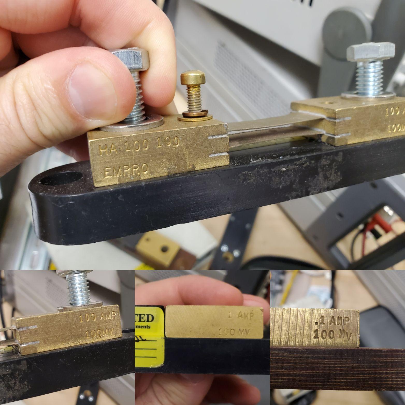

That said, I started to remember my marine experience, and the fleet of trash skimmer boats NYC once operated. In this design, there was a split 12 VDC and 24 VDC systems. Both of these systems had ammeters, but the meters were run off a shunt. The shunt was where you’d hook up the ammeter in any situation, but the terminals had #10 screw posts on the lugs, where the wires would run up to the wheelhouse, and the meter was wired in. It was an excellent setup.
Has anyone ever seen a setup like this?
Yep use them all the time in our world they provide a pretty exact voltage drop for testing, ours for example are like 100A = 100mv, 1A=100mv or .1A = 100mv..........
Pretty much the easiest way to get the DC current readings in line. Then you get a meter with the same output and change the scale face on the meter.
So the meter would be 0-100mv input, and would have readings on the front scale like a 0-10 scale, 0-100 scale, our scales pop off in most cases.

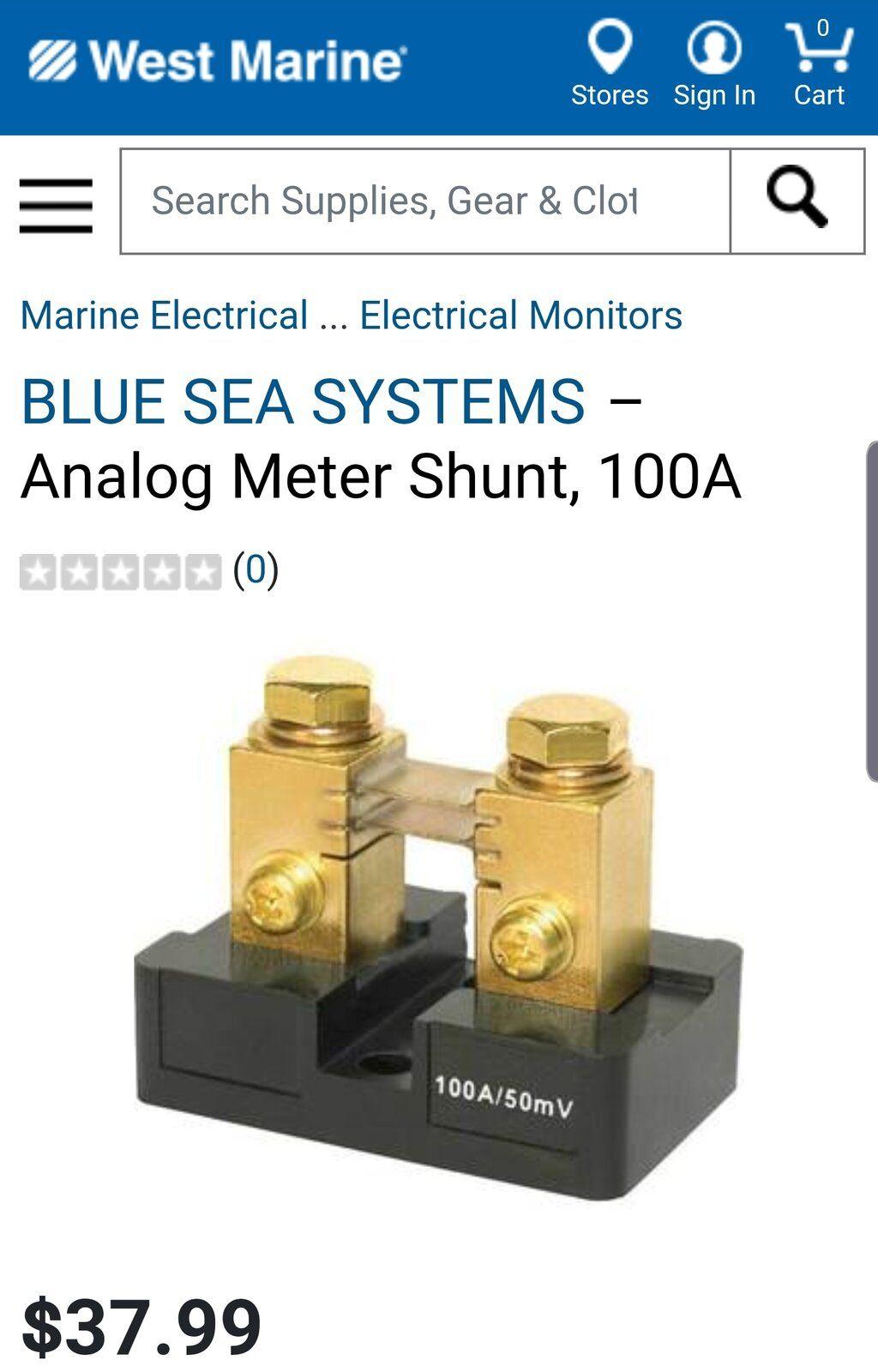

Looks like a Marine shunt 100A to 50mv, is like $38, there is a note on the page....
For continuous operation, it is recommended that shunts not to be run at more than 2/3 (66%) the rated current under normal conditions
Big trucks use a shunt for the ammeter where it was just plain scary to run the amperage through the ammeter gauge in the dash.
I will check today and see how much one is, and also who makes it. Stewart Warner I think..

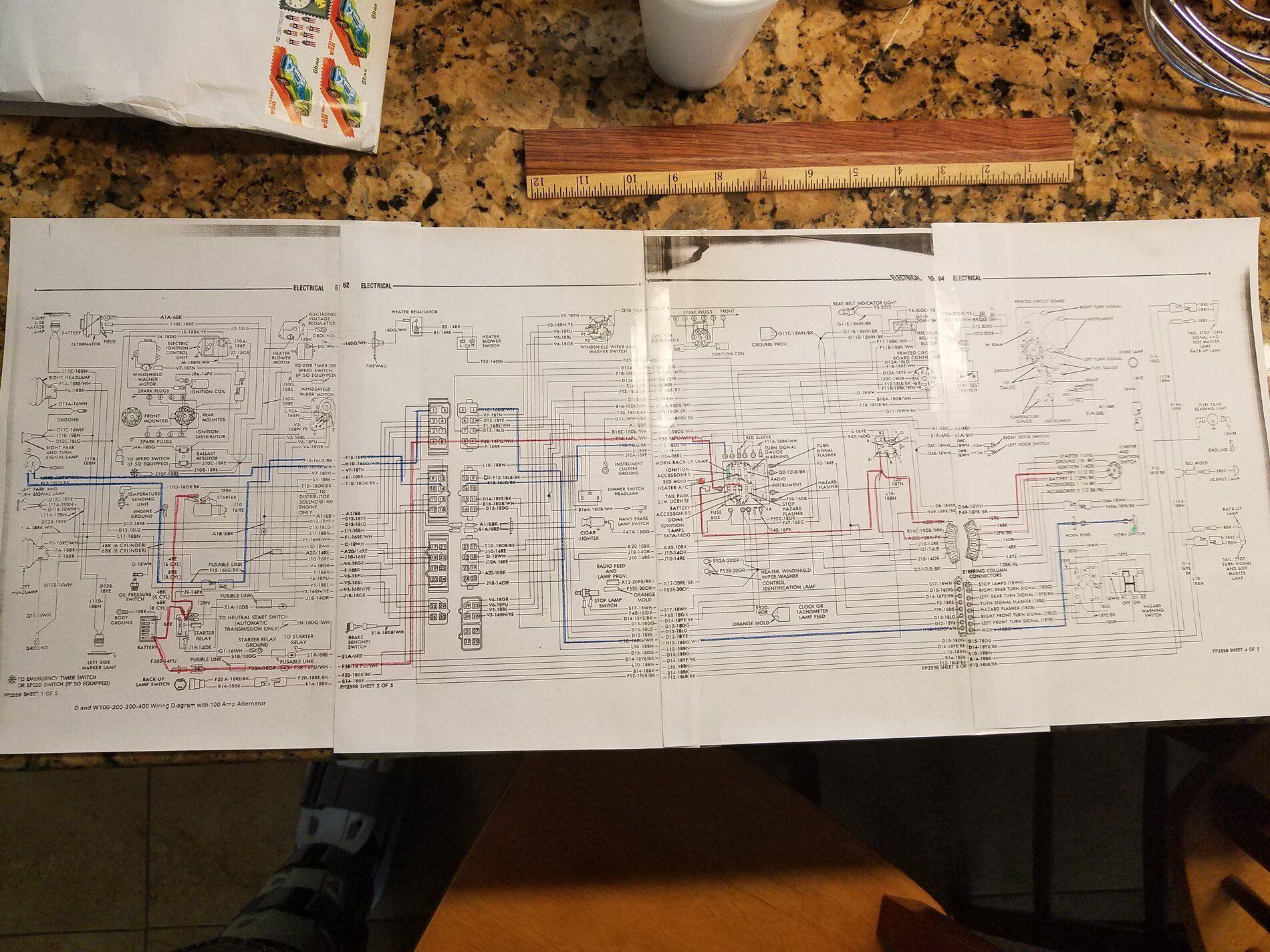

Thanks! Here is the current wiring diagram and I'm starting to create a modified one now.
Cheers, Ron

A little bit challenging to see real clear but it looks like that is exactly what A1A/6BK is doing direct from ALT to ammeter.
What say you?
Gary
