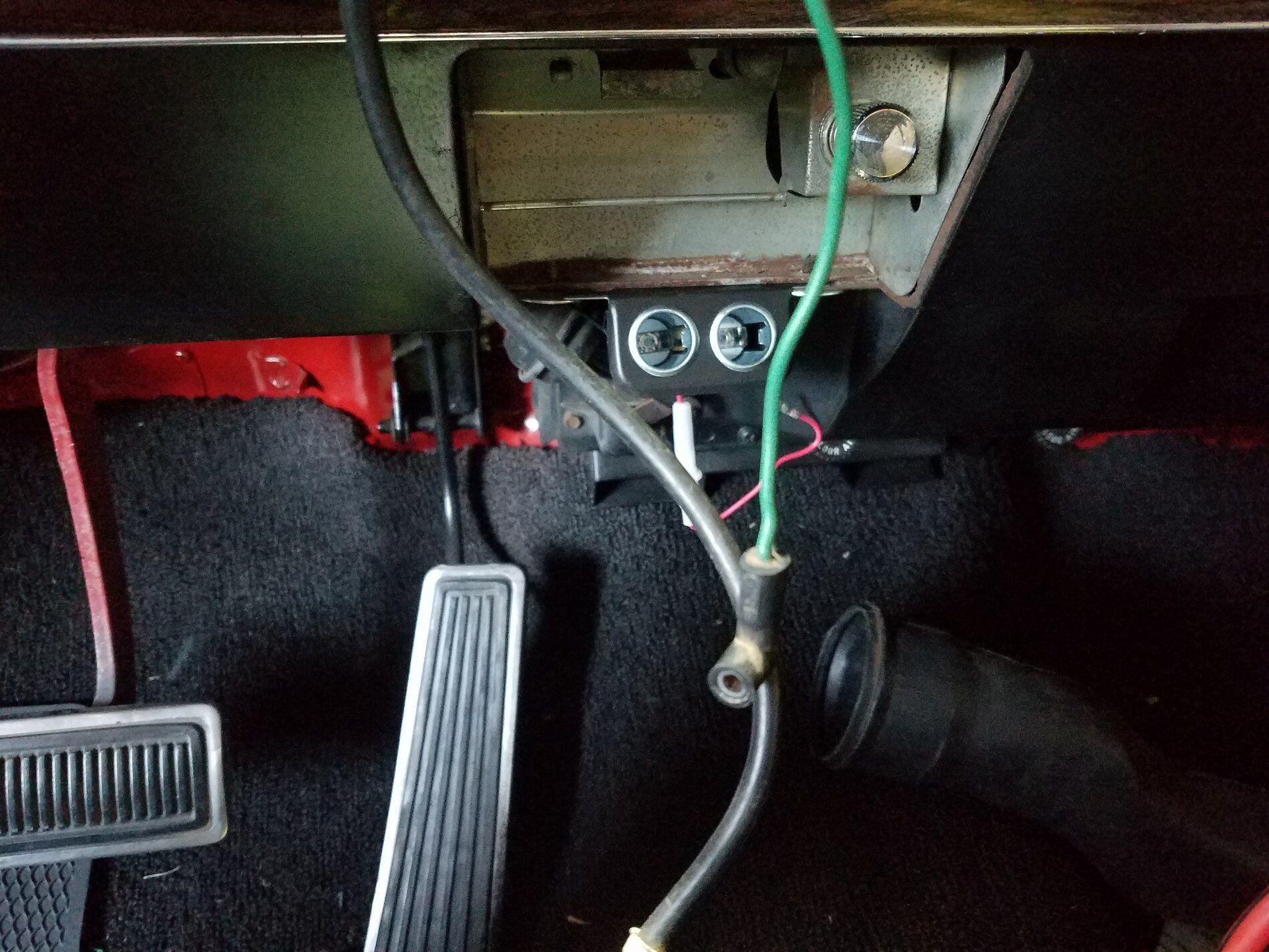

Today, I added dual 12VDC receptacles, wired the radio plug with remote on lead for amp and subwoofer, and wired but not installed LED under dash lights. Here's pics,
I discovered there is no glove box light nor switch and couldn't find any new or used on line. I'm engineering a plunger switch and LED license plate lamp. Won't have the switch for a couple days, so I'll run the circuit and light and complete when the switch arrives.
Cheers, Ron
Always something you discover that needs to be added a nice touch light in glove box. What is the dial for under the dash for?
Looks to be the original cigarette lighter perhaps?

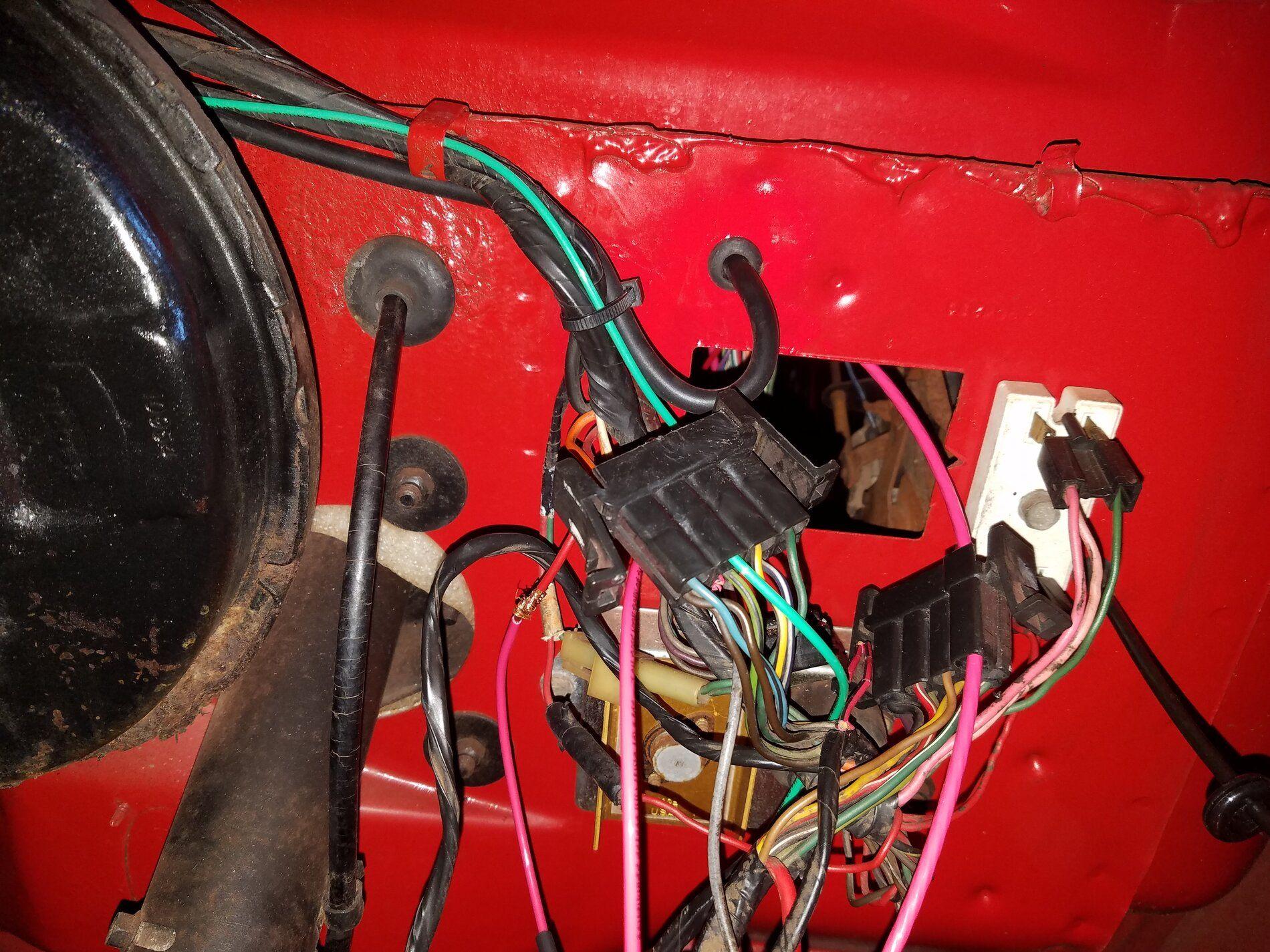

Normally don't work on Sunday, but had catch up. I ran the leads for the optional volt and vacuum gauges, drilled the firewall and ran/ T'd the vacuum gauge line into the trucks vacuum line. New vacuum line is right above the electric connections below.

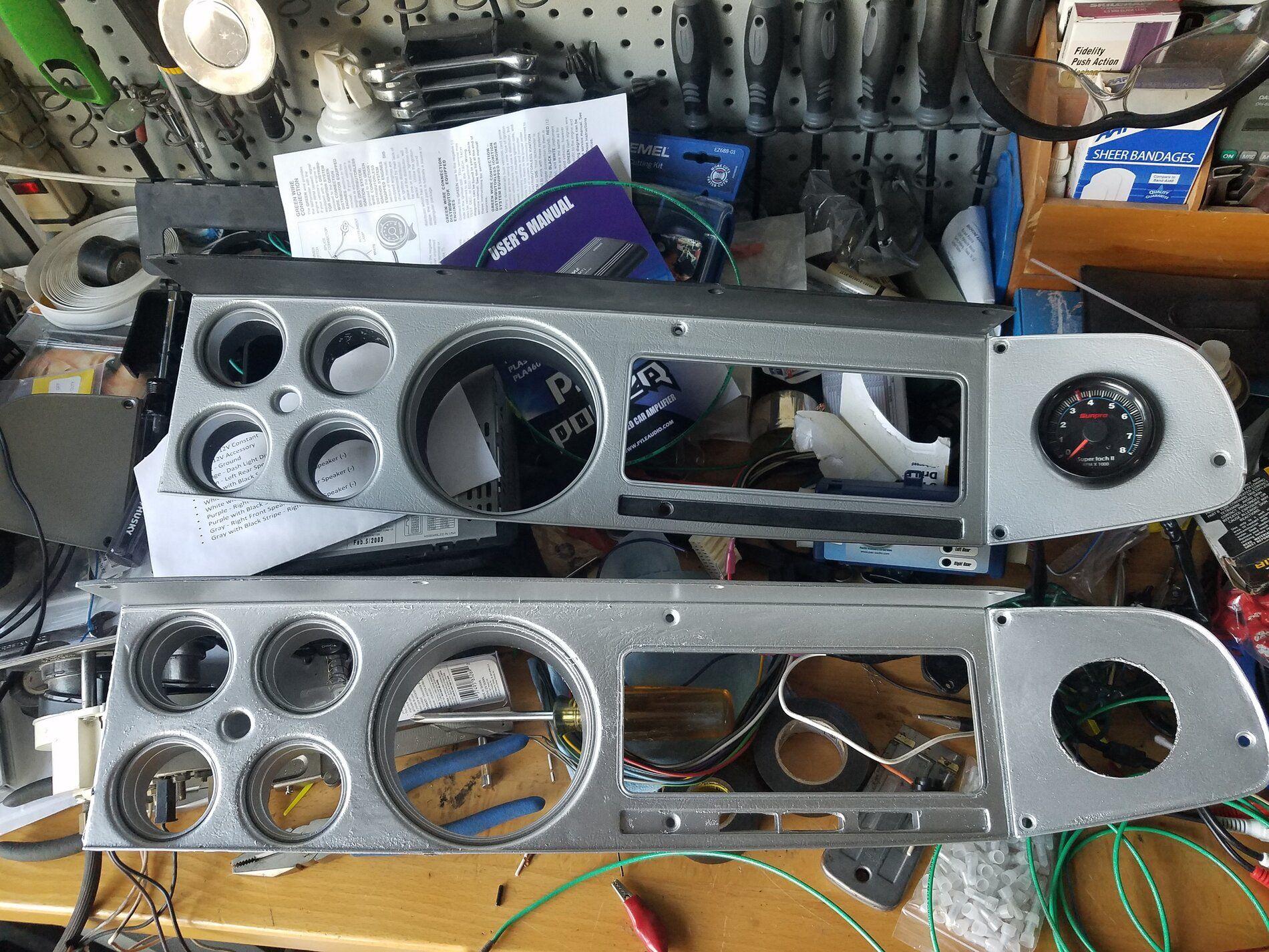

The original silver dash was pretty smudged and fresh paint didn't make it look better. Someone previously likely wiped it with mineral spirits or some other chemical that removed the texture of the plastic. Fortunately, I had bought another dash panel on Ebay when I was skeered of ruining the original when drilling the tach opening in it. Of course, now that I'm a veteran driller, it was cake. See difference below.

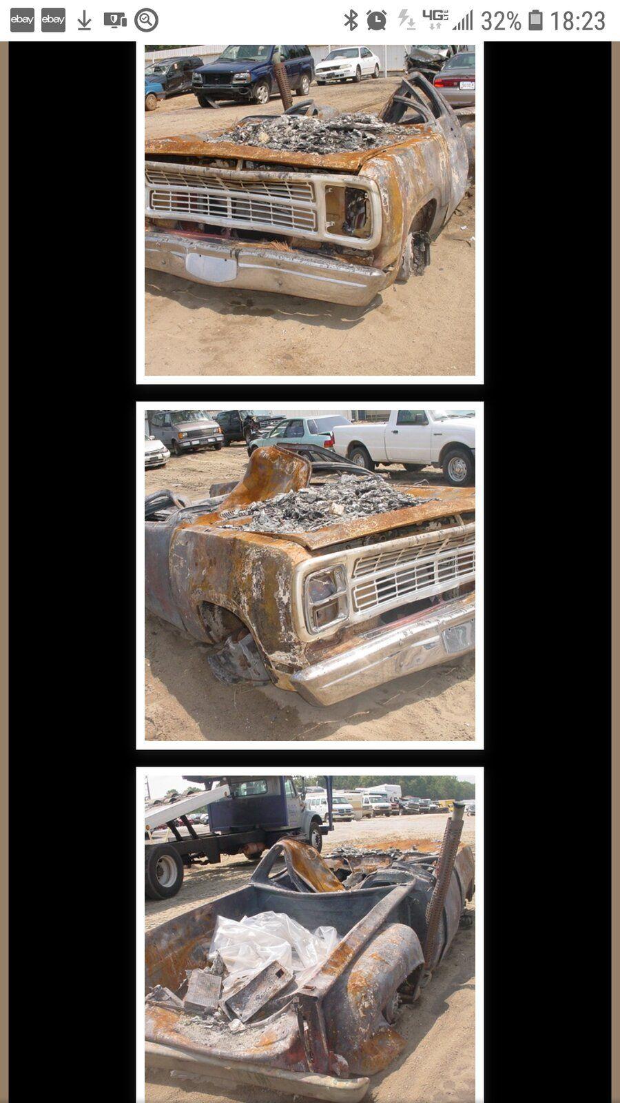

Wowzer! The electrical engineers packed a lot of smoke in those wires for sure!
It looks like someone already got the only salvageable parts...the lug nuts.
This truck was the worst configuration for high current issues with 60 amp alternator and factory air conditioning. The blower switch and connector, the fuse panel, the wires on the ammeter, and some firewall connectors were fried and two of the four fusible links were nearly fried. Lots of circuits and connectors were reconfigured and upgraded.
The 100 amp equipped trucks at least had a gauge or two larger wires, but still had all current flowing through the dash. Before I button up the dash, I may connect the ammeter in series with radio so it will show flow, but won't be a true ammeter any longer.
