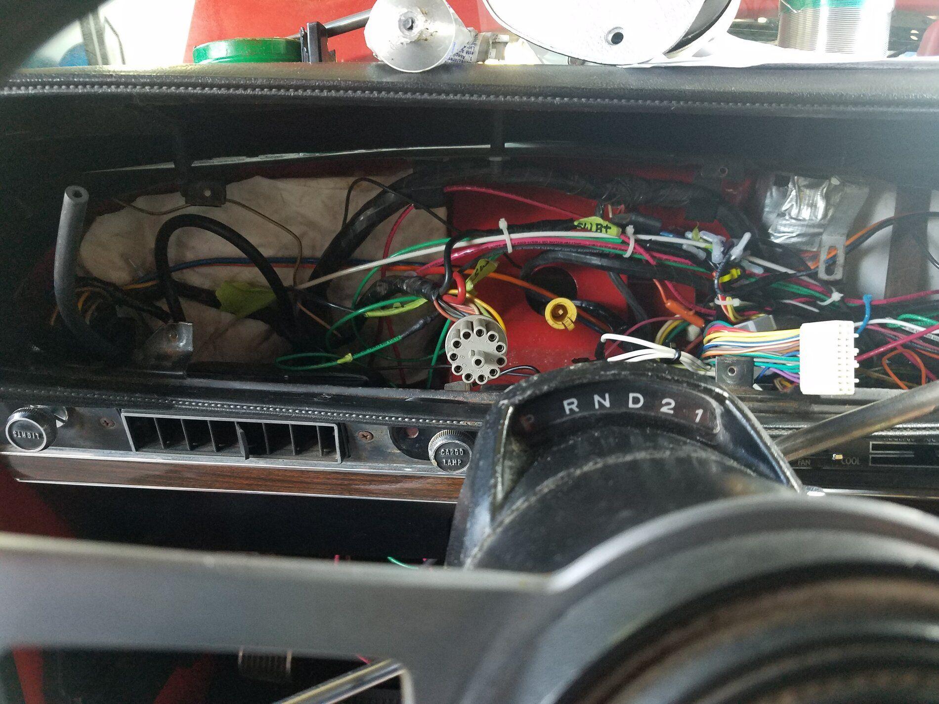

I completed all the connections in the dash and have dressed up most of the wires. The wires between the truck wiring and the fuse panel could look a little nicer, but it is easy to access and everything is labeled.

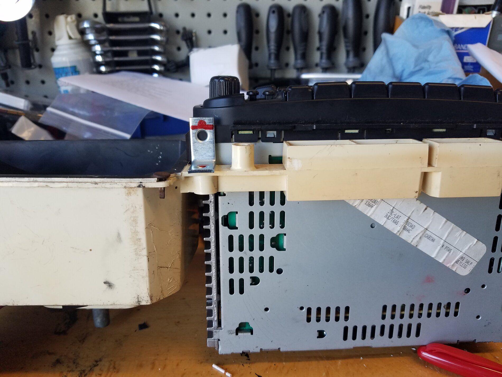

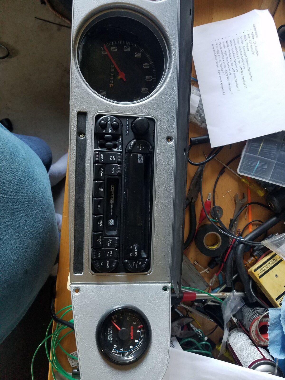

Well, I decided to grind the plastic face of the 2003 Ram AM/FM/CD/Cassette head unit. Took about three hours to figure out what to do andto do it. I didn't alter or modify the dash at all. It fits nice and looks factory.
Gotta fabricate a left mounting bracket tomorrow and install/connect it to the dash.
All in all, I'm pretty happy with it.
Cheers. Ron

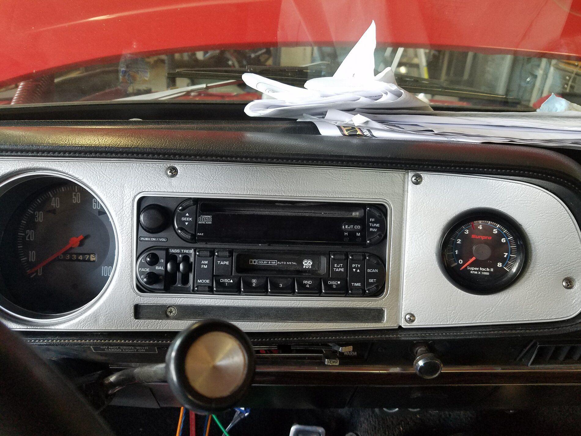

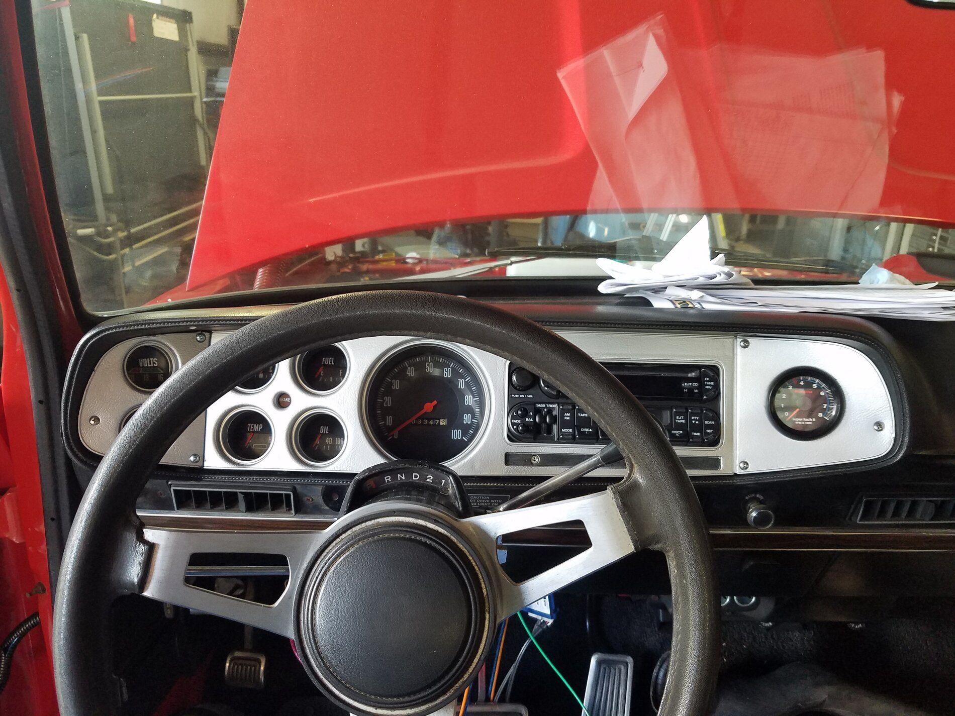

Friends,
The dash is buttoned up. :D

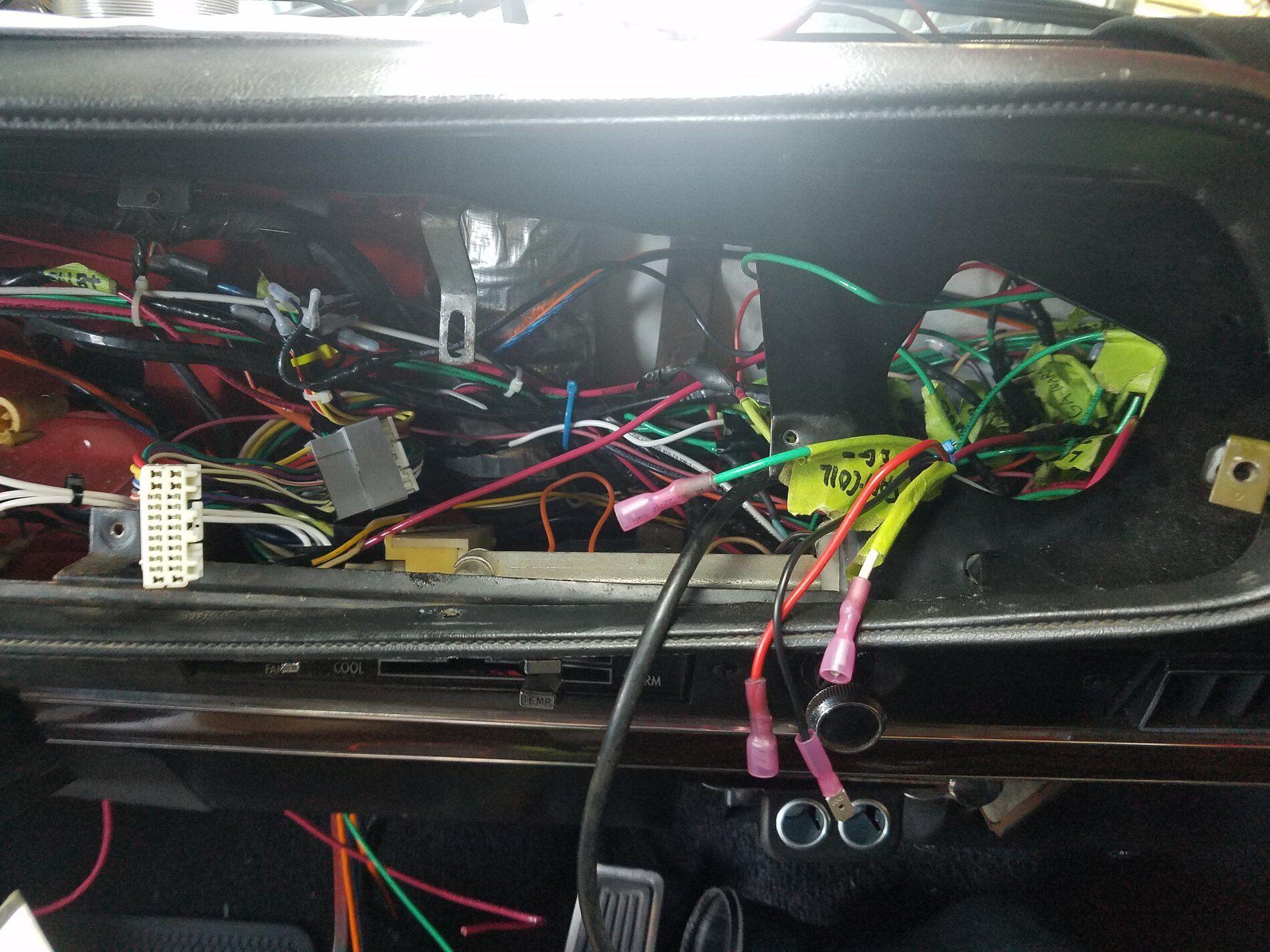

I completed the glove box too. Got to drill another hole in the firewall for the amp power, clean all the connections from/to the battery, and intermediate connections.
Should be able to hot test the electrical system Wednesday, and start the amp/sub install tomorrow as well. Going to a friends birthday party Saturday, be nice to drive the LRE.
Cheers, Ron

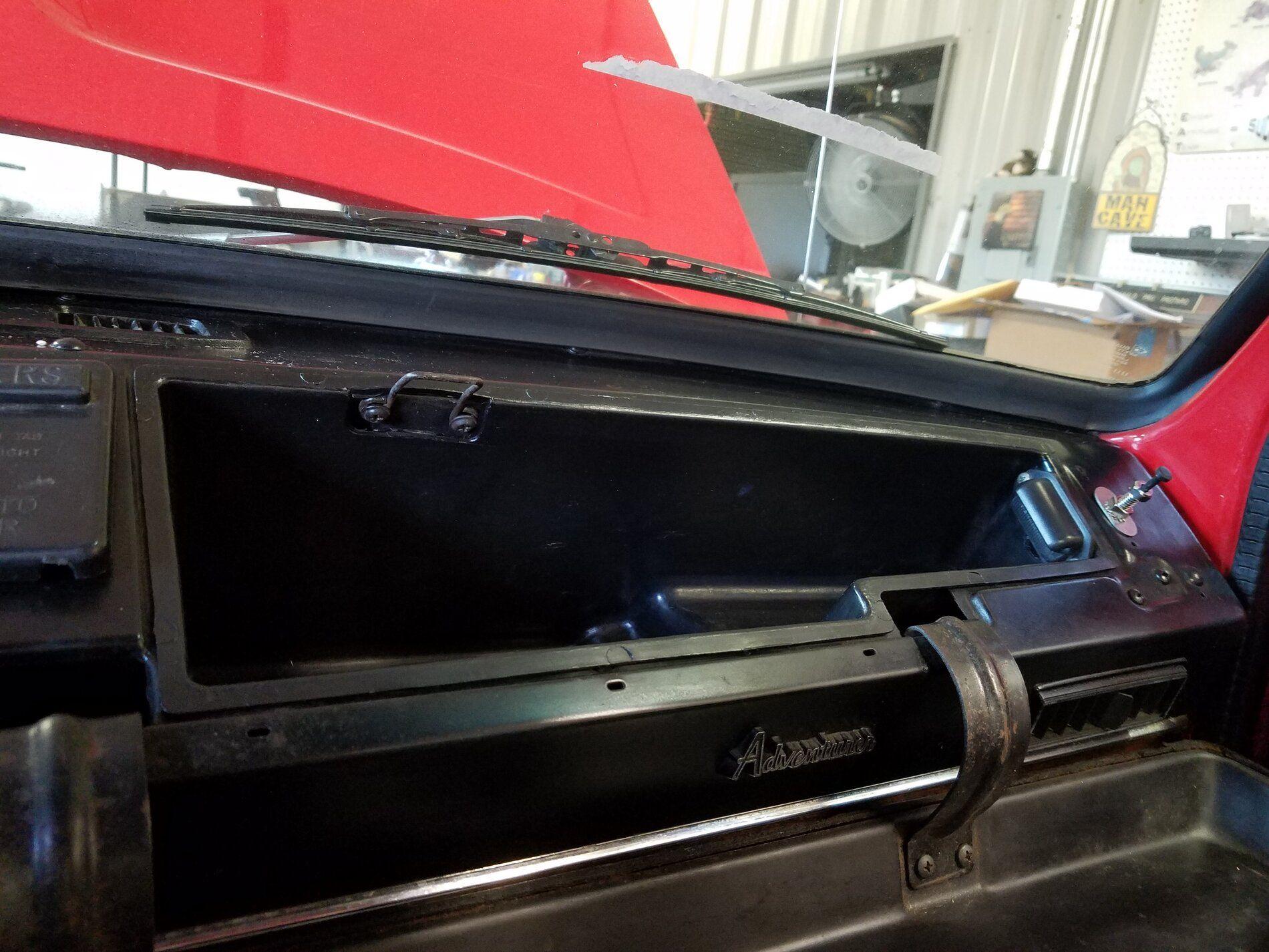

Here's the glove box, tested operation with multimeter.
Regular door vehicle door switch repurposed.

I really like that glovebox light. You're gonna have a lot more light than the factory initially authorized. Great improvement. That radio really makes the dash look much better than with the OEM setup. Lots of class in looks and function. You, sir, have done well.

The turn signal does the right side work ok the bulbs; have that notch in them pretty fool proof but guess can be beat, great your floor lights work how about the glove box.
