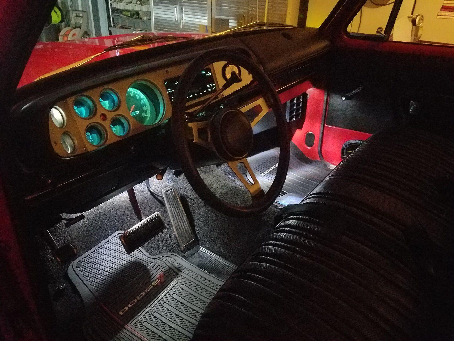

Just a quick pic after getting home from the party.
Real happy with the under dash LEDs. Didn't realize the OEM optional gauges I added on the left don't have the blue green color bulbs like the rest of the dash. One more thing on my future list.
Cheers, Ron
Ron, I believe some of the instrument lights (like the heater controls and ashtray) used what was called a light "condom" which was a silicon sheath that was put over the 168/194 style bulbs and equivalent bayonet bulbs. I used to have a bunch of them, but used most of them on the trucks my sons and I had acquired over the years. They got real scarce in the late 90's.
I found a source at Summit https://www.summitracing.com/search/part-type/gauge-light-bulb-covers. Not sure about the color accuracy for the dodge trucks.
Under dash lighting looks fantastic! Love the clarity and brightness. So much better than the dim power hungry incandescent bulbs of the past.
