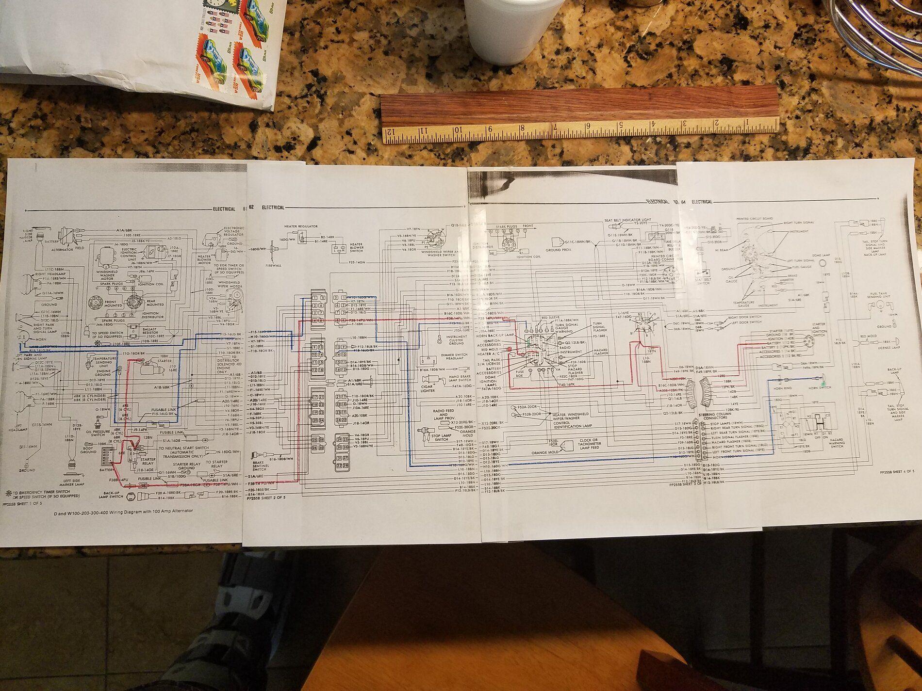

Just thought I would share I swapped leads on field connectors on the alternator... Now truck starts stronger. It was wired wrong on the previous non-functional alternator too. I have about the least experience of anyone on alternators, so can't say succinctly it matters, but sure seams like it. When starting, the voltage to the coil is increased while starting, then reduced while running.

Anyhoo, happy to hear from the gallery if I'm correct or if I have a vivid imagination about the exciter field (?) connections of the alternator.

Regarding the alt field circuit, IIRC, it didn’t matter which spade went to which wire. You still have that wiring diagram, right?

I do have the truck wiring diagram... red lead goes to ballast resistor, electronic voltage regulator, electronic ignition control unit, accessory of ignition switch; light green lead goes to electronic voltage regulator.
IIRC that is accomplished through the ignition switch Start and Run contacts and the herky ceramic ignition resistor on the firewall. The field connections shouldn't make any difference as the output polarity is determined by the diode pack and regulated by the voltage regulator.

Do you have a schematic or diagram of the alternator itself showing the rotor, stator and diodes? That is usually shown in the description of operation section. I remember reading something about one of the fields being a ground plane in the circuit for some applications of some vehicles. Just not sorting very well anymore in the organic calculator/memory cells. It's apparently joined the "cloud"; too much information stored and everything is getting "cloudy" in retrieval mode.
