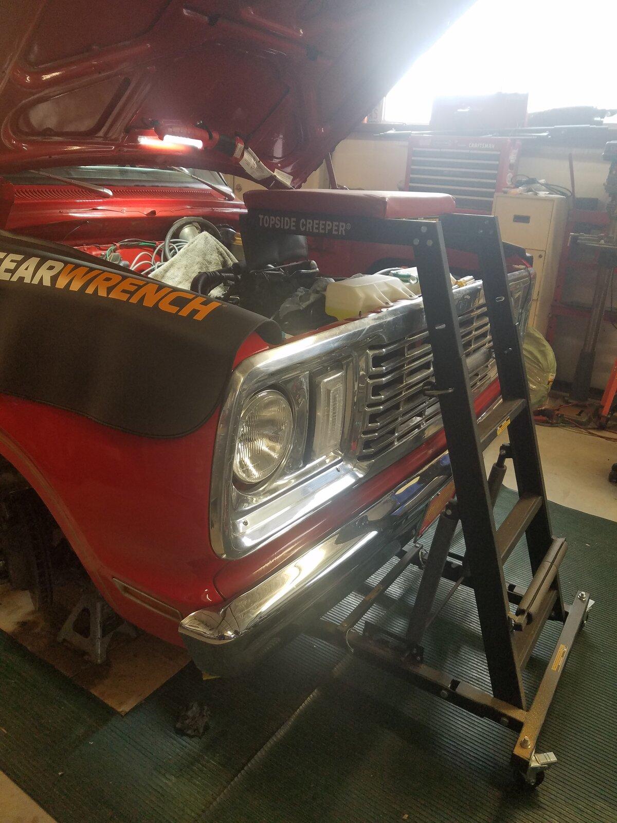

Stopped to sip coffee... before it's time to have a be-eer. Going topside to inspect back of engine, vacuum lines and whatever. Thought I'd share the BEST tool I've bought in the last 20 years... the topside creeper.
No more balancing on ladders :eek: or laying on the engine :oops:....AND Amazon has 'em free chipping.:p:D.
Che-eers, Ron

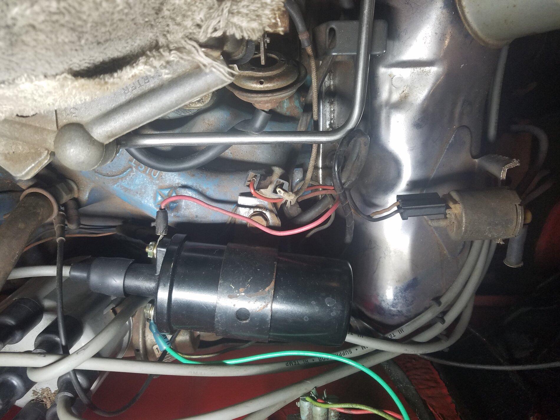

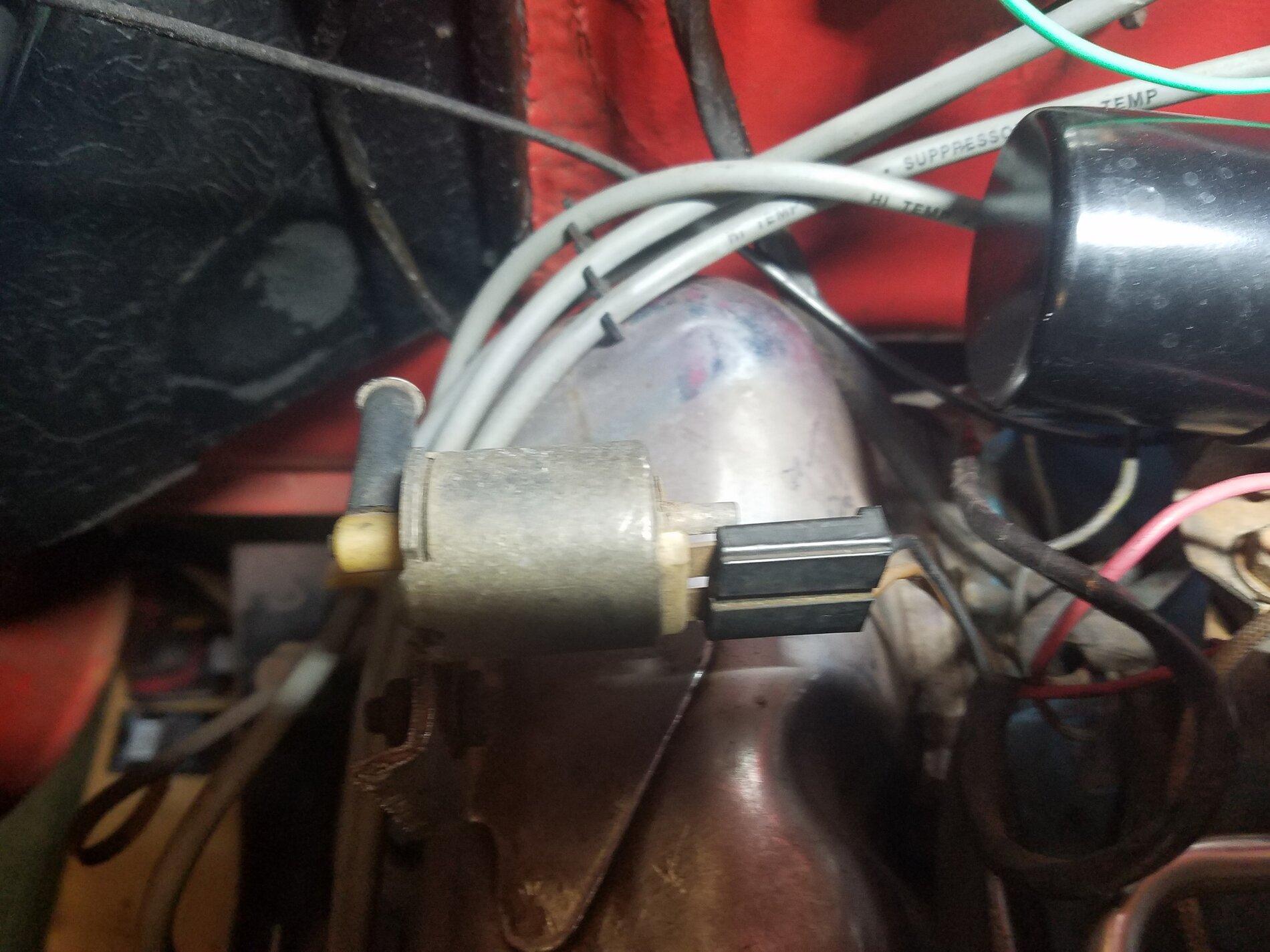

New discovery.... backyard mechanics bypassed the vacuum solenoid for the throttle positioned system and ran straight vacuum from the intake manifold to the vacuum throttle positioner. Think that has an impact on the engine?
So, gonna run everything right and see what's what. OEM manual has some test to verify operation. Buddies coming over for Ribeyes and pool at 1700, so gonna run these vacuum lines and call it a day. Might need a short nap to get ready for company after this.
Cheers, Ron
Oh the treasure working on top part, then look down in dark corner and discover something mickey mouse that will need to be repaired next, eek.

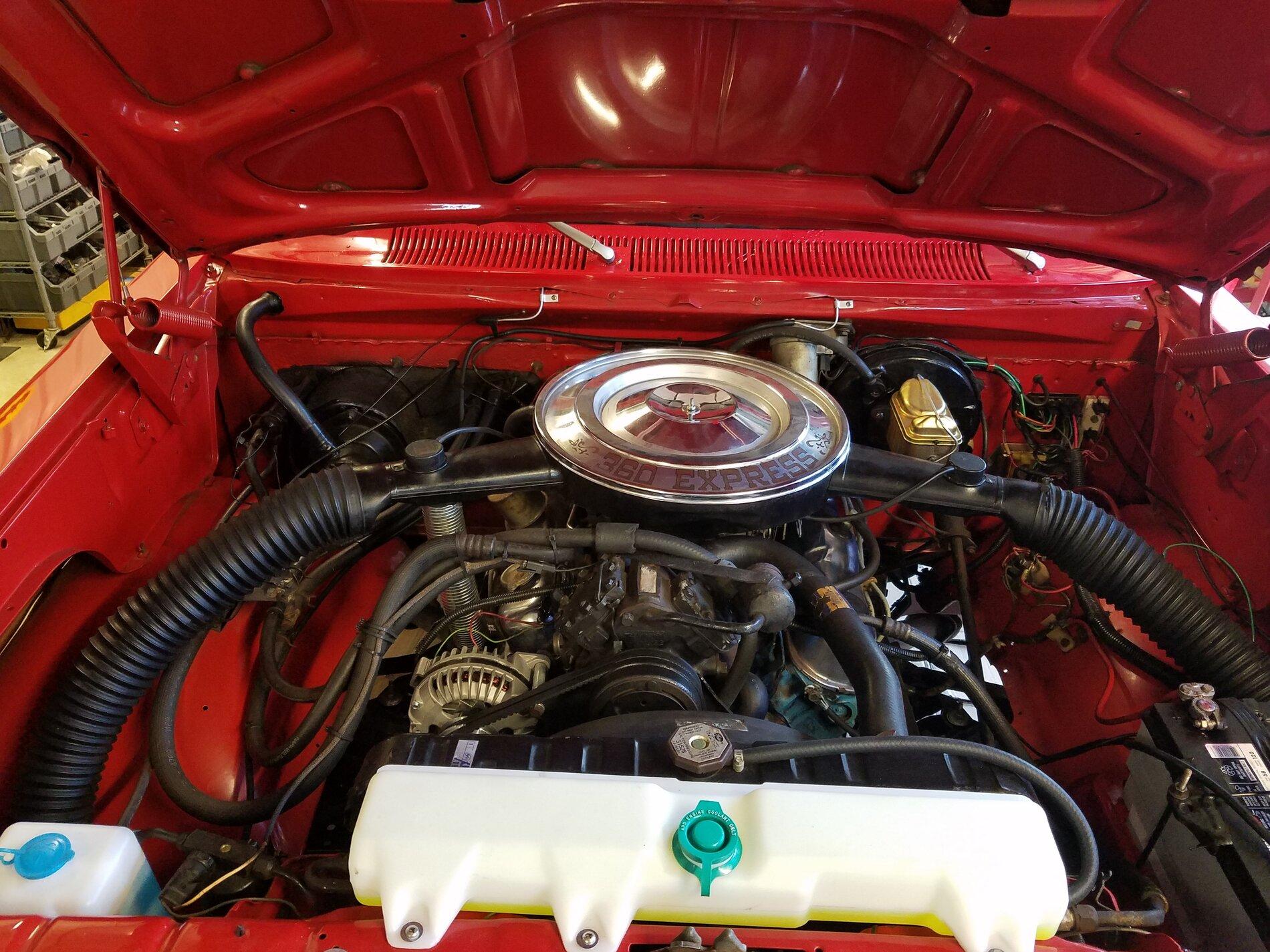

Friends,
At long last, the LRE is back on the road. I ran all the vacuum lines, ran the windshield washer hose and installed the windshield washer nozzles. That was fun.... first effort was shooting washer fluid over the truck hitting the top of the tailgate. Here's the completed engine:

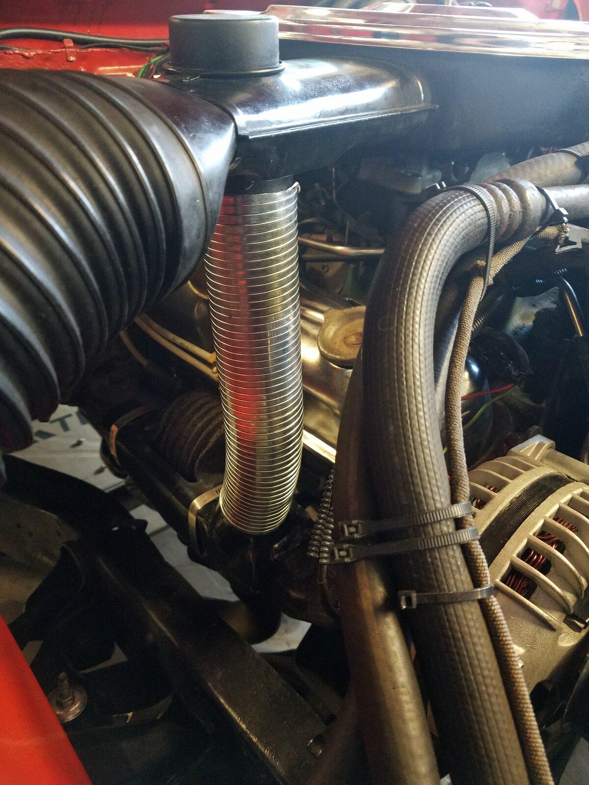

I measured and cut the 2inch flexible exhaust pipe and fit it onto the exhaust manifold and onto the air clean intake horn.
I guarantee it will not tear like the aluminum foil ones.
Took her for a spin this evening and was nice everything working on the truck. I'm pretty much calling the project complete. In few months I'll get the A/C working, but 2/70 works great, especially with the wing vent windows.
I will post time to time when there's pictures or events.
Cheers, Ron
