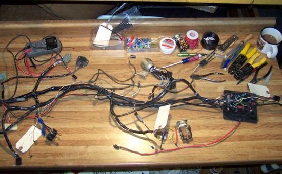

Hey Ron, why not ditch the fusible links and wire in Cole Hersee self resetting breakers?
Hey Wayne,
there must be telepathy going on here...I was just about to ask the TDR gallery if fusible links could be replaced with self resetting breakers. You think 40 amp good?
Thanks, Ron

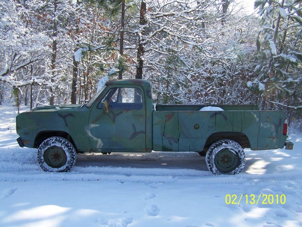

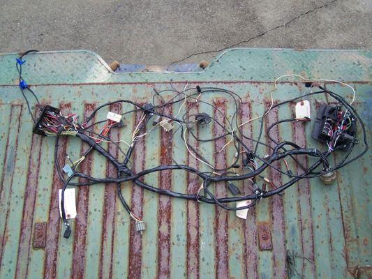

This was a few years ago, my M880 needed wiring TLC too. And a rare snow day in SC. Sold it wasn't getting used enough to keep it.
Gary

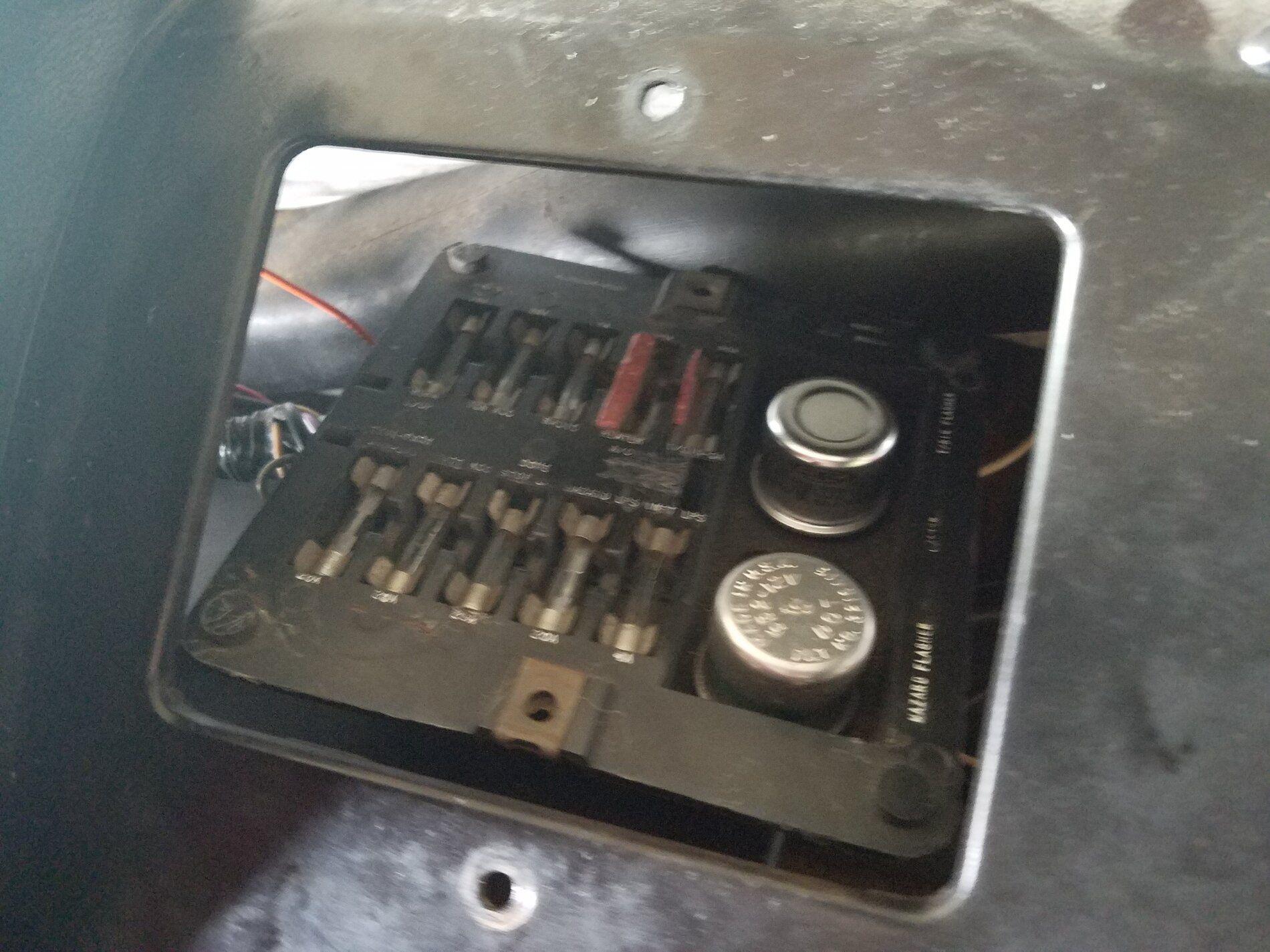

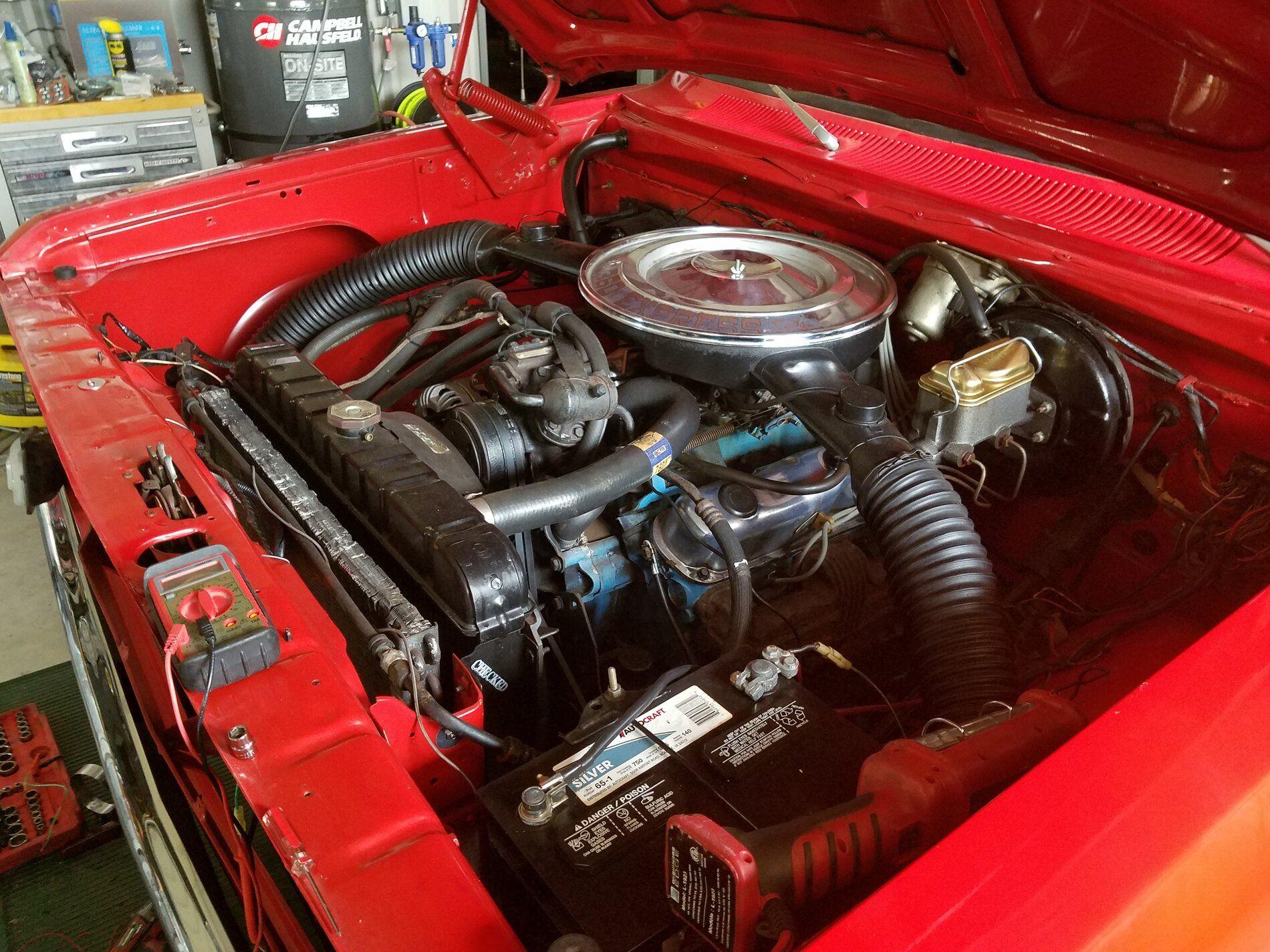

So, back to my troubleshooting today. Woke up 0300 this morning thinking about checking resistance from the pos battery terminal to each feeder connector on the BACK of the fuse panel. feeder terminal on the bad leg was ruined. I read good continuity at the connector, replaced it and back in business. Horns not working, so I disconnected them and tested voltage 12.6VDC. Tried the horn from the truck and no workie. Gonna use my 12VDC converter with fuse to test horns to get them working.

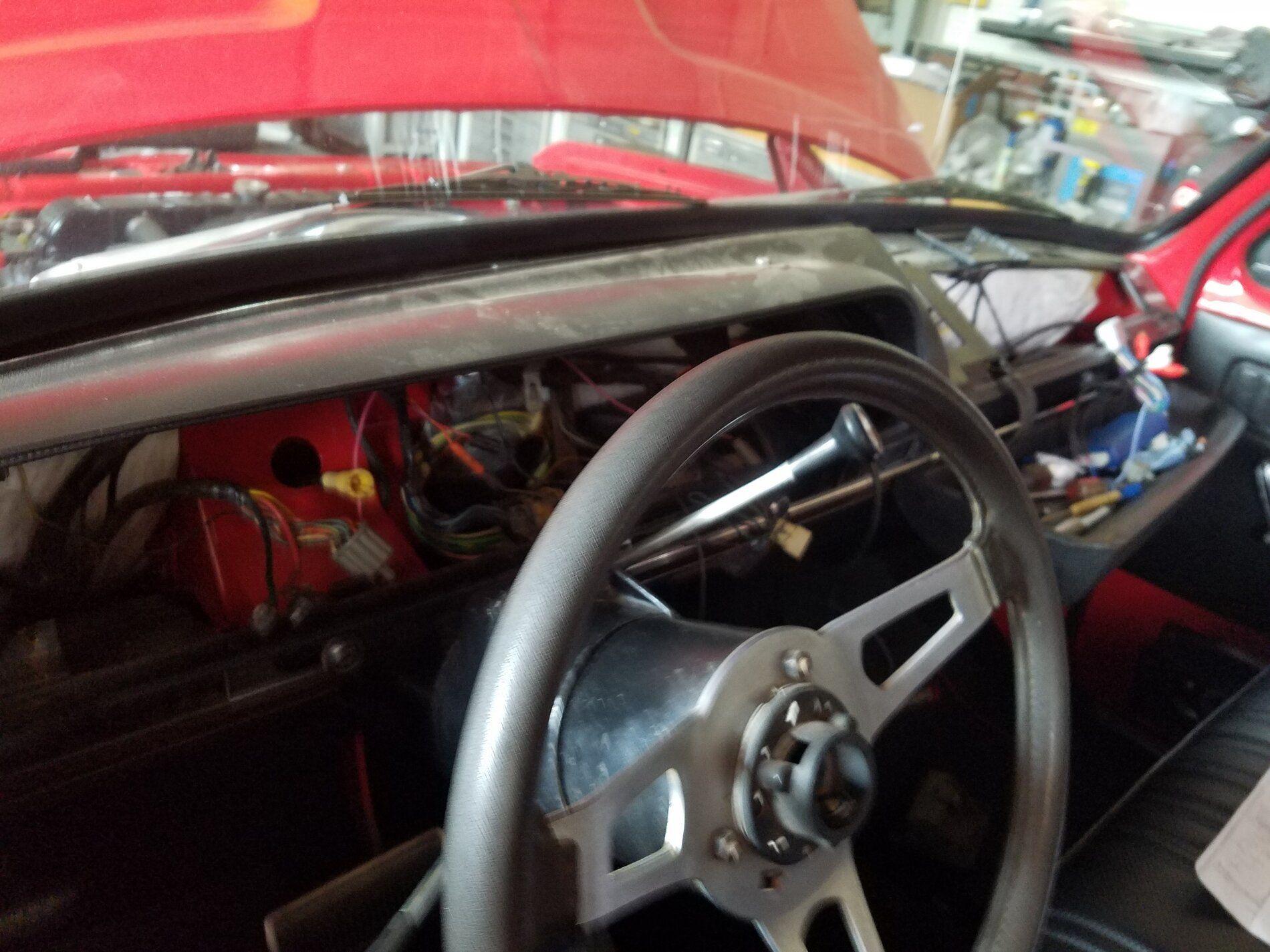

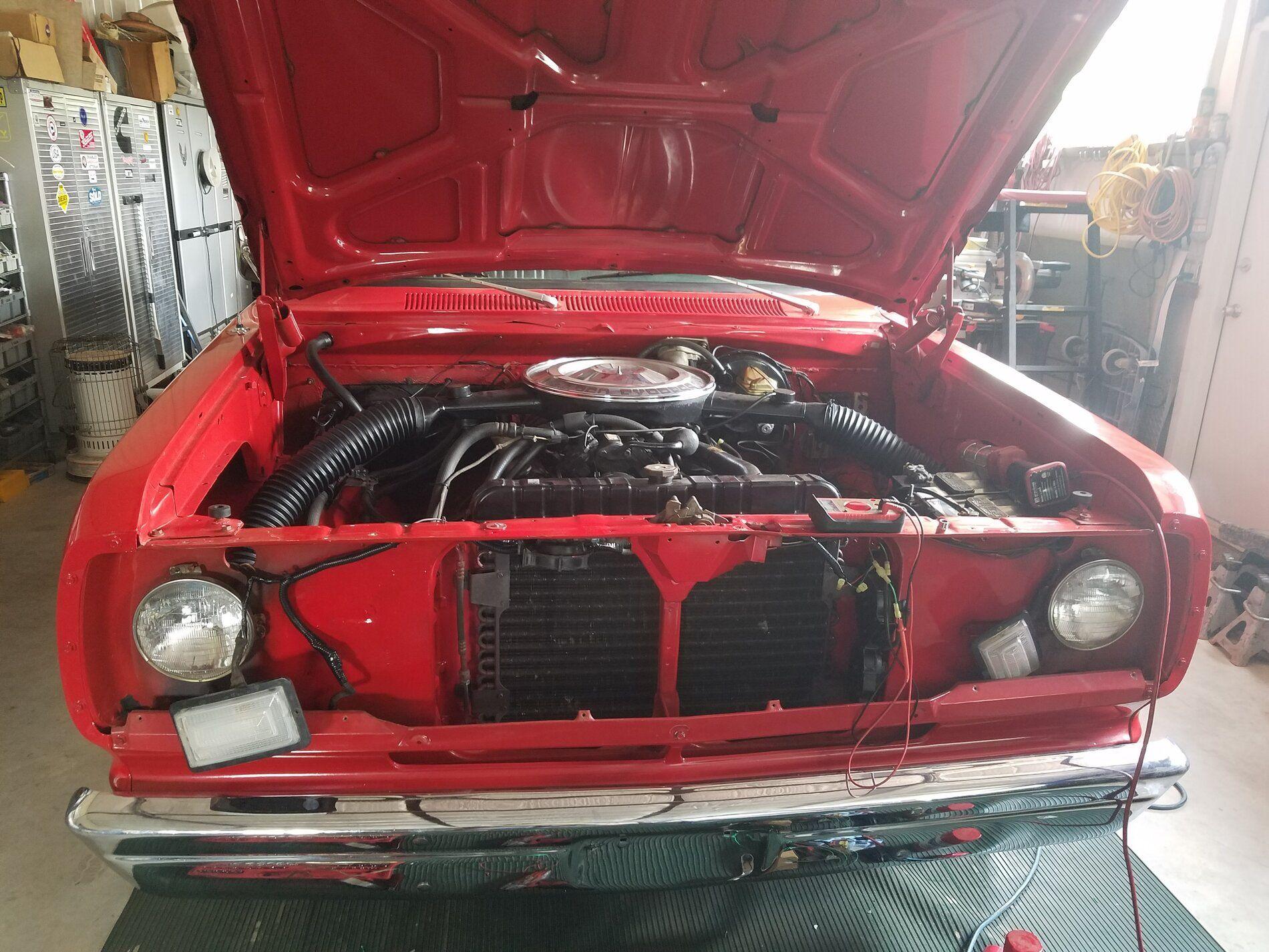

Yep, think tomorrow I will carefully remove the firewall connectors, clean with some contact cleaner, and add dielectric grease to them, and every reachable connector on this truck. Snapped some pics a bit ago;
Thanks and Cheers,
Ron
As I’m thinking about old Mopar horns, the contact behind the steering wheel could be at fault. Maybe find that wire in the column and ground it?
It looks like a new horn, read 12.6VDC at the horn connectors, and reading good continuity from horn wire in steering wheel to horn connectors. Tomorrow, gonna bench test horn to see if it needs adjustment. it's likely it never worked since the restoration, especially since it was connected to the windshield washer pump connector. The horn leads had been cut off and dangling behind the grill.
EDIT: My best tool, multi meter with gator clips and 15 foot gator clip extension.

I'll admit I've slept since those pics were taken but something about the bulkhead connector does ring a bell, like the M-FM spade connections or something was wonky. It did take some chasing and tracing, new connections or even a straight thru non OEM style line to the starter circuit but it was repair for service, not for restoration.
I bought that M880 non running a bit on the what was I thinking at the time. Misc repairs, carb work, fuel pump and a new timing chain and I had something.
