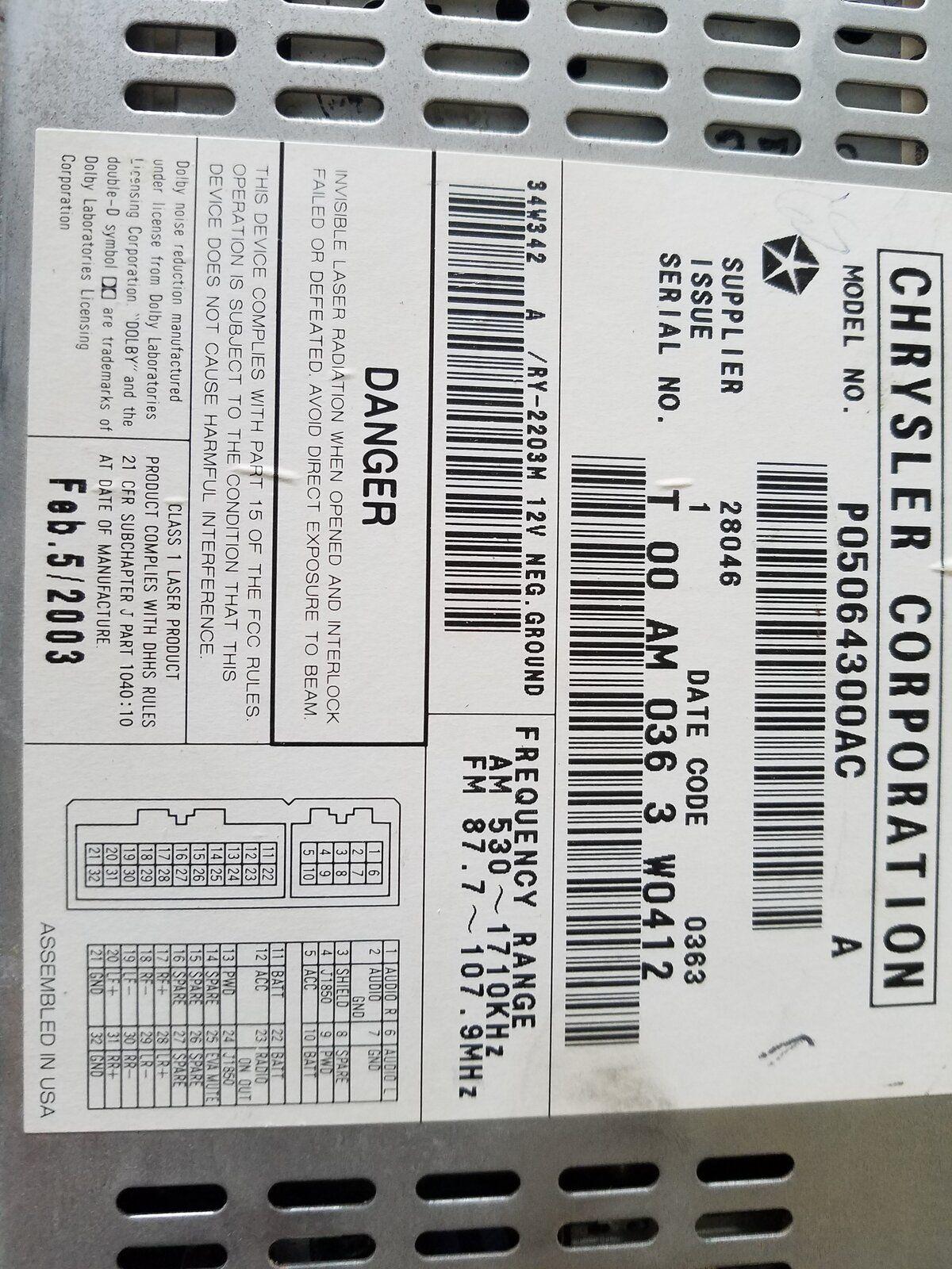

Now, having a slight sentimental moment and bench clean and test the stock OEM AM/FM stereo (Top). I have a Serius XM FM modulator that will work if I can the radio to work. If not, I'll use the AM FM CD Cassette (bottom) and Serius XM FM modulator.

What is the build date of that RAZ?
I might be able to help you with a tip that won’t require that horrible FM modulation.
I added Sirius satellite radio to my 2003 RAM 2500 with an OEM stereo very similar to your RAZ....
Greg,
Feb 2003.

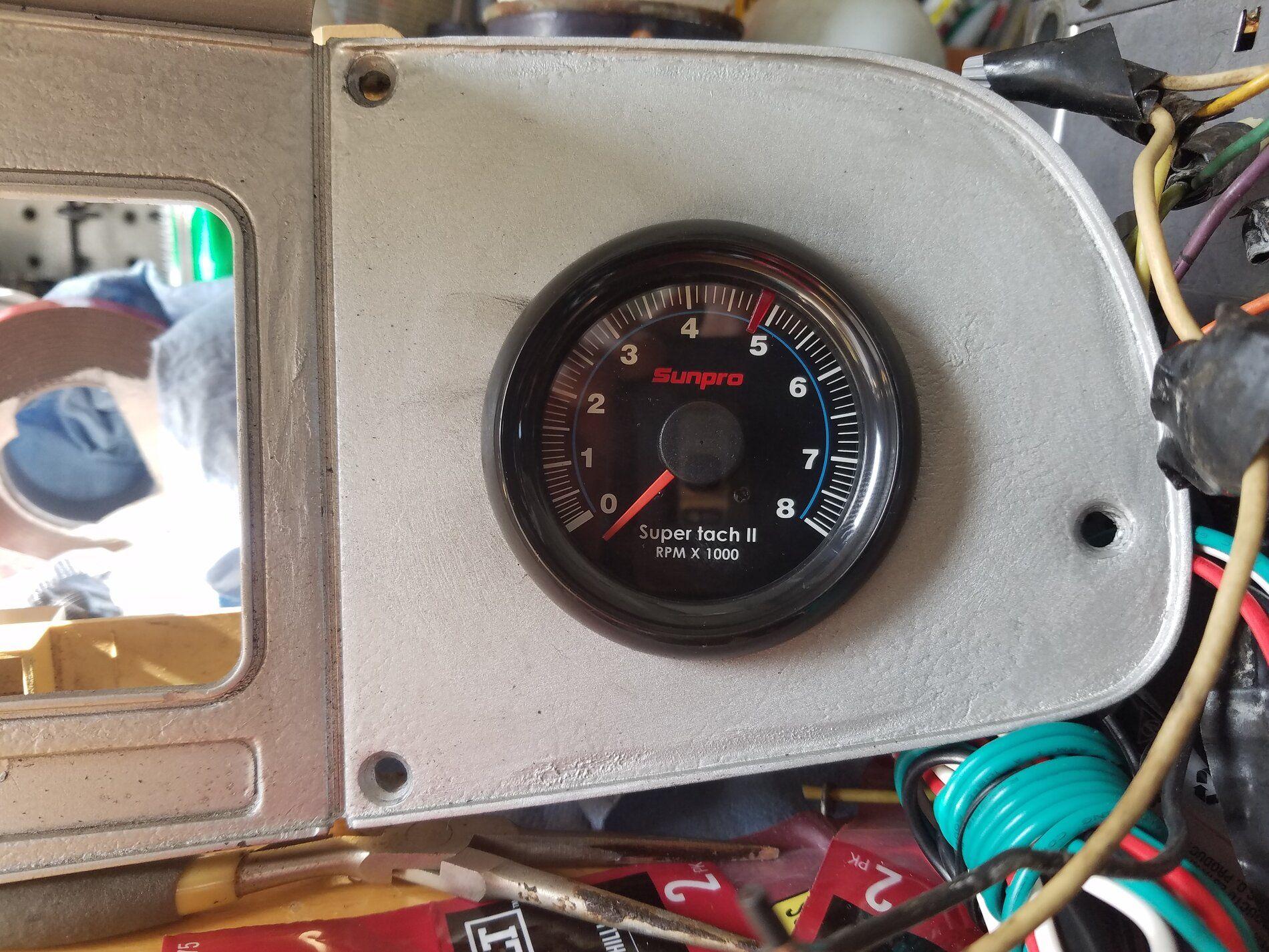

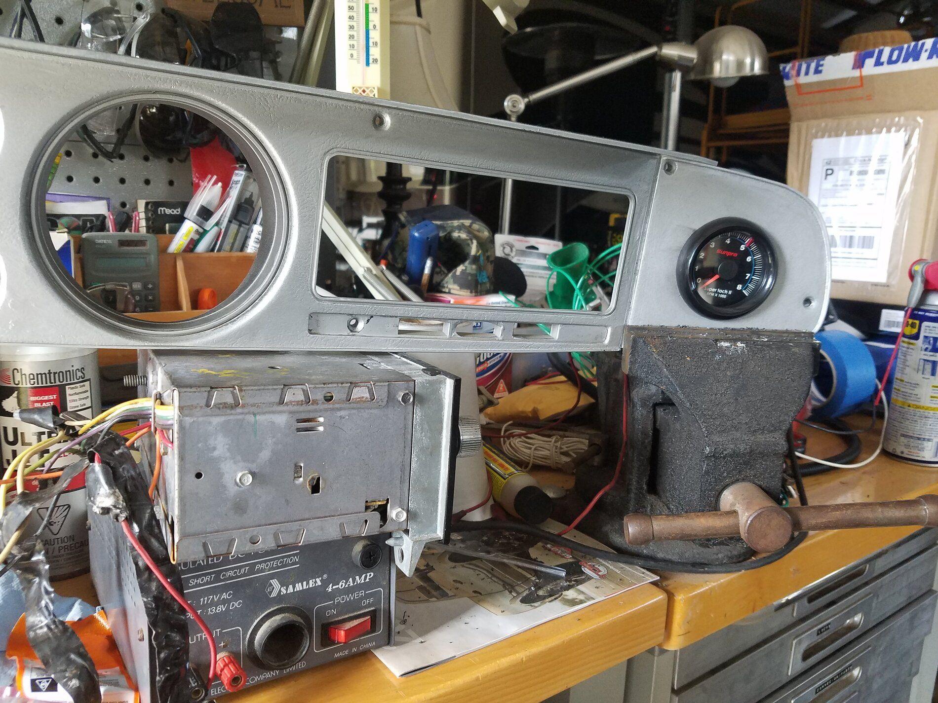

I have LOADS of patience AND time. I've fixed the firewall connectors, now going to open every lug, connector, and ground in the engine bay and the REST of the truck, inspect, clean and grease. I'm going this far, might as well do ALL the electrical on this truck. Might be another week before I actually start working the radio. I found a nice dash panel on eBay I want to receive and inspect before I use a hole saw on the dash panel in the pic. It's 41 year old plastic. Securing it without breaking it AND not damaging it in a vise I'm studying on as I go through all this other "preventative maintenance."

Friends,
I guess y'all's lights got brighter as I came up with an idea. You think a hot knife would work better than hole saw for making 2 5/8" hole in the right plastic panel on the dash. I think hole saw is too violent a well as jigsaw.
Maybe drill pilot hole and use coping saw?
Unfortunate result of being a type A is once a challenge or requirement is entered into the Bat Computer, it runs continuously until it spits out an answer.
Down in the Bat Cave right now trying to figure it out.
Thanks, Ron
If you use a hole saw do it from both sides. Less of a chance shattering the plastic doing it that way. Kind of like doing door knobs, dead bolts etc., never hole saw completely from one side as splintering will happen.
Or if you can find the "grit edge", toothless hole saws they work well in composites and plastic.

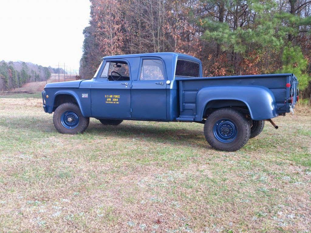

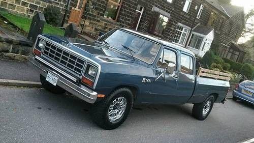

View attachment 115010 I put a few of those on the road when they were brand new . I was a line mechanic for Dodge dealer . Here is mine CTD powered
I love it man! I've been a Dodge guy my whole life. The US Air Force bought W250 Crew Cabs with step sides, 4spd standards, and 225CI sixes.
And later with a 318V8
Thanks for the post.
Cheers, Ron
Friends,
NO FEAR! Thought about it, placed dash panel in vise, supported the panel with STUFF on the work bench, used standard 2.5" hole saw at slow speed, cut the hole nicely, used the Dremel sanding barrel to smooth it out.
BIG BUBBLES, NO TROUBLES!
Nice snug fit, could easily hold without the clamp, but will clamp anyway. Ankle sore today, so for today, "THAT'S ALL FOLKS."
Cheers, Ron

Ron, that Tach looks great! Its a Sun SuperTach! As retro correct as you probably can get.
