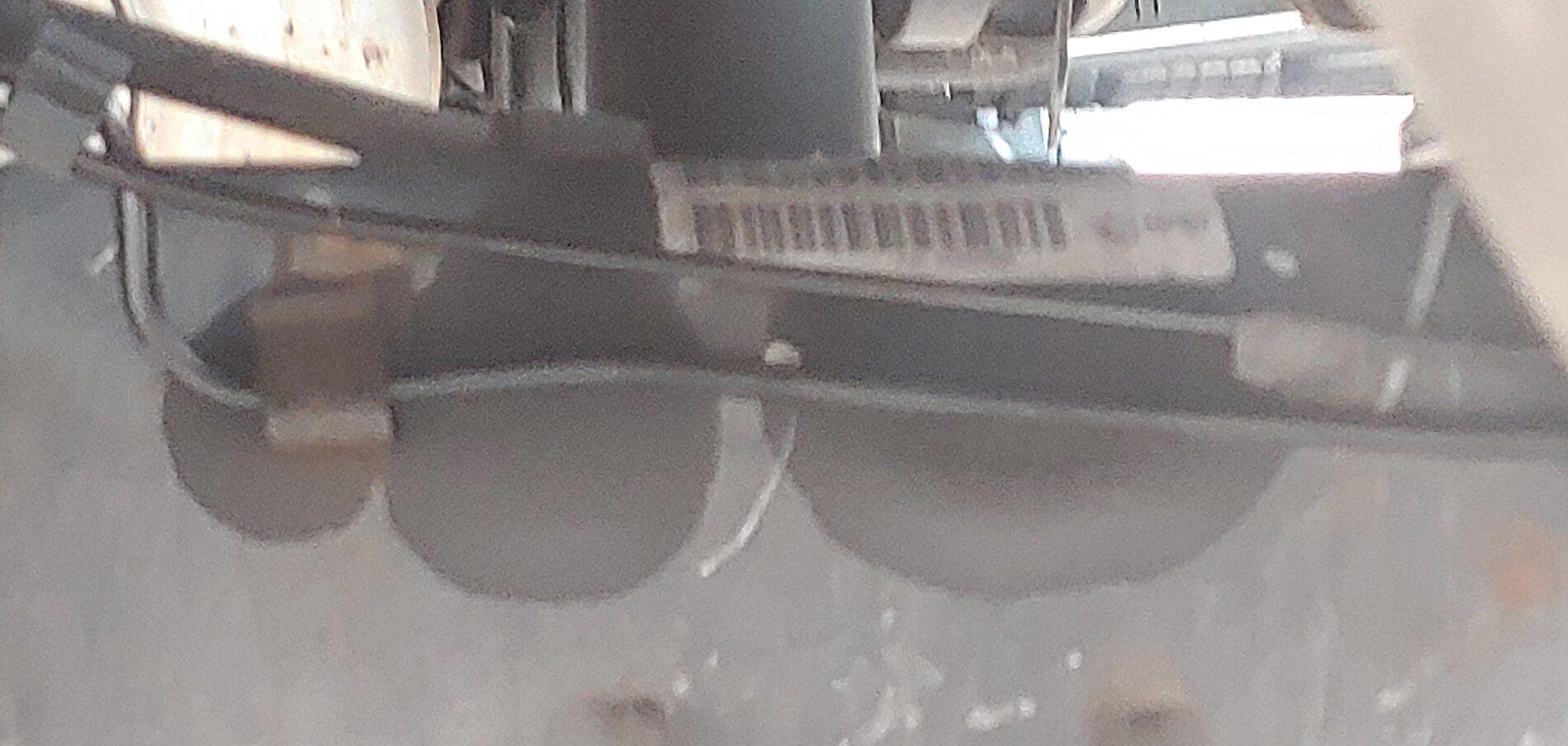

Looks like i may have a slow leak from a brake line. I guess i will need to see if my MaxCare covers brakes. Almost looks like maybe vibration and corrosion?
I may have to wait until we get to our destination, tho. West coast. Brakes work fine and slow loss from the reservoir.
