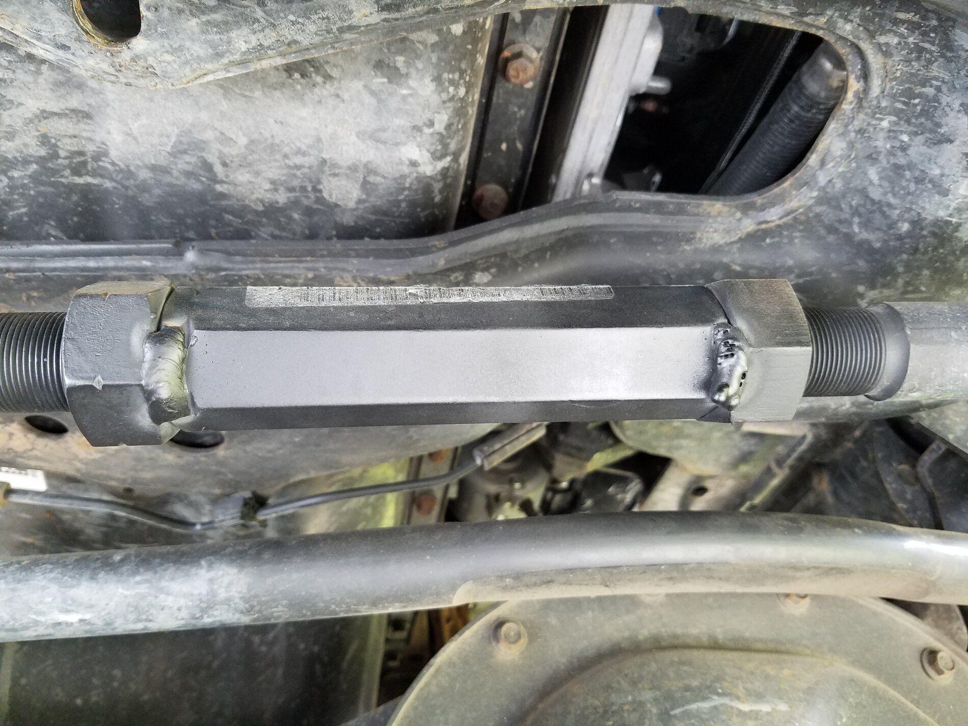

I just put a Thuren leveling kit on my buddy's 2016 2500 - after having done mine. He saw it and couldn't resist. It was a lot easier doing it the second time and with a set of giant tall jack stands so I could really drop the axle. BUT:
He had just had his truck at the dealer for a few small things and they welded the drag link! They did put on a pretty nice weld - WHICH I HAD TO GRIND OFF TO RESET THE STEERING WHEEL TO STRAIGHT after installing the new springs! I was a little worried about how difficult it would be but it turned out to be pretty easy. I adjusted the link and then painted the collar and the nuts again - while trying to avoid too much overspray.
So that's it. I've officially had to grind the welds from the factory fix in order to adjust the wheel. It had to happen to someone first!
That's why I said it really isn't a big deal. More time spent complaining here about how lousy a fix it is than it took to grind a couple inches of weld off.

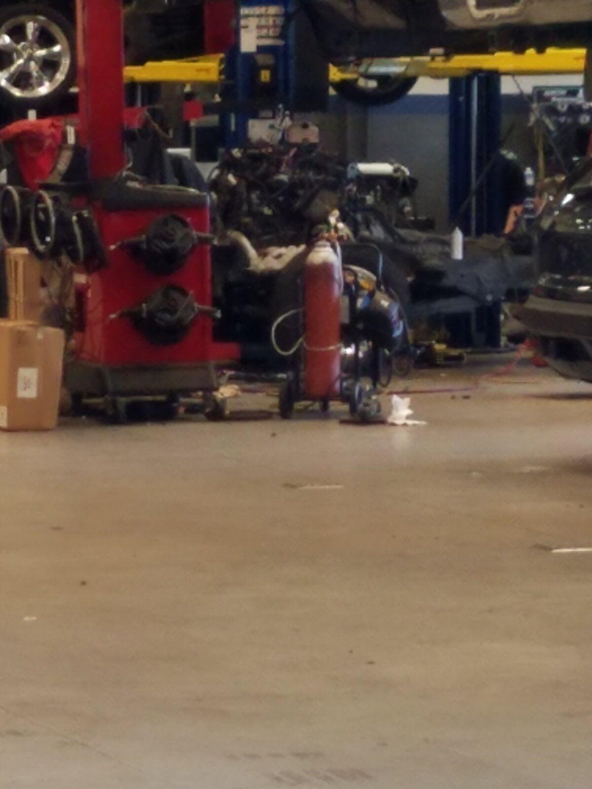

Here are pictures of the welds and the welding equipment used on my truck yesterday at West Hills Ram in Bremerton, WA. One weld looks like
a practice weld, the other looks good.
The whole process took about 20 minutes, including welding, testing torques, checking toe in, painting, and doing the tail gate lock recall. Service rep stated that I would get a letter in the fall from FCA, to come in to have the drag link replaced.

Here are pictures of the welds and the welding equipment used on my truck yesterday at West Hills Ram in Bremerton, WA. One weld looks likeView attachment 113242 View attachment 113243 a practice weld, the other looks good.
Did yours fail the test? From what everyone is saying, that is the only way you get a new drag link and welding is "the fix".
But at least they are using a welder with shielding gas. It looks like he may have forgot to turn the gas on with the weld on the right and why the small holes. Done it several times myself when I was still working as a body tech. You realize it the instant you hit the trigger.

My welds done in the last month look like they were done by an experienced welder that understood MIG gas shielded welding.
