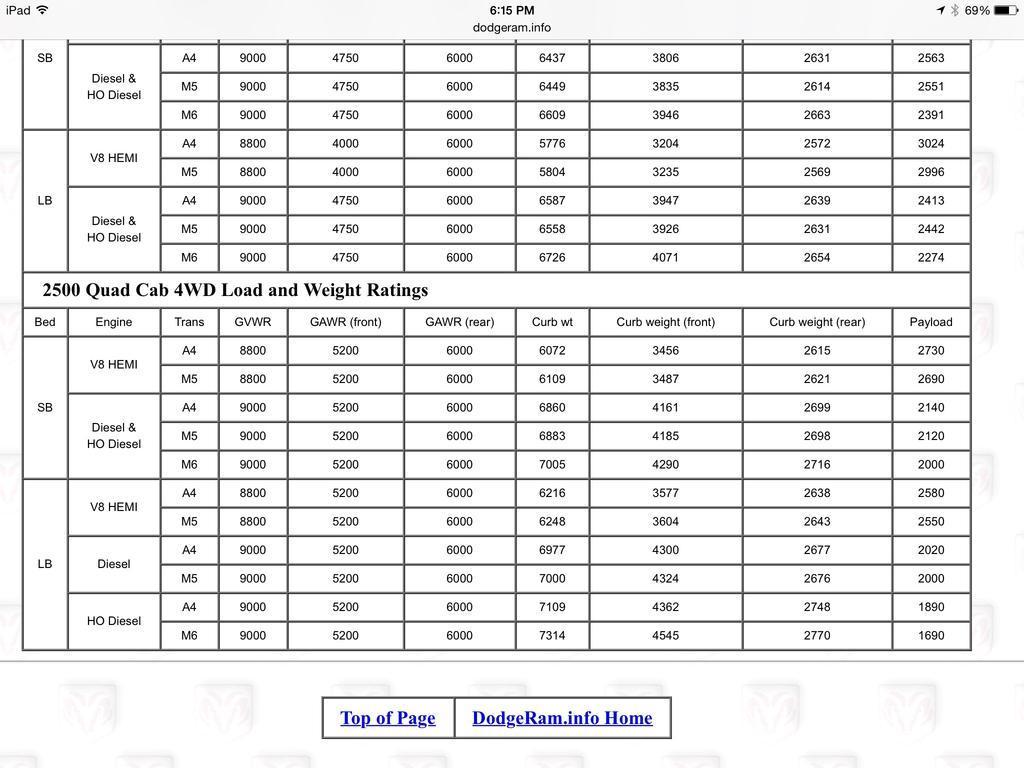

Again, I will repeat. If it has 17" wheels and tires, then it will have a really low 6000 RGAWR, which does not go well with 5th wheels. So one has to factor is the cost of a wheel and time upgrade to 18, 20 or 19.5" tires and wheels. SNOKING
I bought 18 inch rims mounted with stock Transforce AT's on ebay. I don't regret it. But i will never buy Transforce again. My 2013 chrome upgraded wheels were 17 inch. They didn't offer 18 inch on 2013's
Again, my 2004.5 In my signature has 6000 lbs RAWR, the scale wt. posted is close to the OP 5ver in question. Again, it's safe to tow and within its ratings. If the OP's rig is within all axle ratings, it's safe. Should he tow at 85mph and tailgate cars who can stop on a dime? NO...... Would a 3500 DRW be safer? Yes...... But he can still legally and safely tow the 5ver, if within axle ratings.Again, I will repeat. If it has 17" wheels and tires, then it will have a really low 6000 RGAWR, which does not go well with 5th wheels. So one has to factor is the cost of a wheel and time upgrade to 18, 20 or 19.5" tires and wheels. SNOKING

Software is exactly the same between the two vehicles. Both the SRW 3500 and 2500 are rated to tow the exact same weights, 17,000 lbs (in the new vehicles anyways) and it is far too expensive to go through the effort to physically derate the 2500 series truck. Zero difference except for the rear suspension.The reality (my reality anyway) is that for all of the evidence of same or similar mechanical parts used between the 2500 and 3500 models, for all of the interesting analysis about why these parts are used, there is still no talk about software...
I asked someone else (actually asked him TWICE) to post any factual evidence to support his theory of automatic liability in a civil suit. There is no such thing. The plaintiff would have to show negligence on the part of the respondent. Being over an arbitrary number such as GVWR is not negligence. As stated, the Ram 2500 is rated to a GVWR of about 12K lbs (newest models). The derated 2500 is simply a marketing tool to sell a class 2B vehicle with a 10K lbs weight limit. That number doesn't have a darn thing to do with the capabilities or safety of the truck... it is simply a number decided by the Federal Department of Transportation as a cut off. On certain highways, certain bridges and certain secondary roadways they are limited to 10,000 lbs (5 tons) and vehicle manufacturers sell vehicles to just barely fit under that number.
That is the reason that Ford used to sell a F350 with a 9999 lbs GVWR... to get under the arbitrary class 2B rating. There was no difference between that F350 and a regular F350 except the placard reads 9999 lbs. As has been stated, the number that matters for legality and liability is the lower of the axle ratings or the tire ratings. Exceed either of those and you have some explaining to do.
