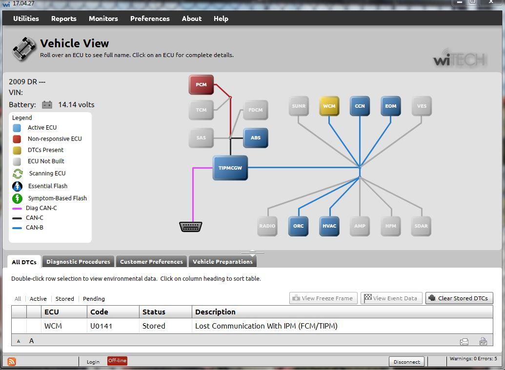

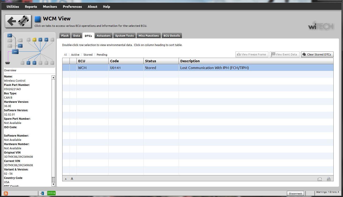

Kept the truck running when I got home, so I could connect with the wiTech and see what was happening with communications on the network. Once again, it was the ECU that apparently decided to stop communicating. What remains weird, is that the other computers are not setting a code for failure to communicate to the ECU.. and the Wireless control module had a stored code for failure to communicate with the TIPM! What a mess. Screen shot of what wiTech displays attached.
Now it appears to be an ECU problem, however.. I'm wondering if there was some type of network glitch that set the loss of TIPM to the WCM, that perhaps made the ECU go into a CAN off state to protect itself? The truck ran perfectly fine, no MIL lights, and great MPG the entire time, as it has been doing for years.. it's a truly bizarre situation.

Based on the witech topography was the truck running at the time the ECM was offline? If it was running normally as you say then that's a witech glitch not anything going on with the ECM. If the truck is already running and the ECU goes offline the truck should continue to run because all the inputs to keep it running or hardwired. However if the module was offline and you shut it off it wouldn't restart because it has to communicate with the TIPM to allow the starter to engage.
The truck was running for that screenshot, but it's not a simple wiTech issue... because absolutely no scan tool or OBD2 device can communicate with the ECU when it goes off-line to the network. That has been the issue all along, but I thought in the OP that the TIPM was shutting off the OBD2 DTC connector... I know now that is not the case, since I can get to ALL other devices on the network, just not the ECU. This screen shot is very much like the other time where I first saw this with the wiTech, that took almost all day with the key on, truck not running, to get the fault to occur.
Also for the read in the screenshot you might see there is no VIN, apparently that typically is provided to the wiTech via the ECU/PCM.. and it wasn't communicating. Now when I ran a report on all ECUs the other devices did show the VIN within them and they were all working properly.
As to the restart, I think you are absolutely correct to say it won't start if the ECU is offline during the start sequence, but that never happens, as I have long noted, I can "fix" the off state ECU condition by shutting off and restarting the truck, which for the ECU is like a reboot. If it goes to off state as I suspect due to hitting it's TX error counter, it resets that to zero during a restart, and thus there is no starting issue.. but you got me thinking! I need to do another all day on key, and see if it will act up, and then try to start.. most likely that will not happen.. but an off and on with the key, and it "fixes" it.
It's a strange situation indeed, but I'm now pretty sure the ECU swap is the next major attempt to fix the problem.. once I get it and can flash the ECU I have on order... that will be an adventure in itself, I'm sure.

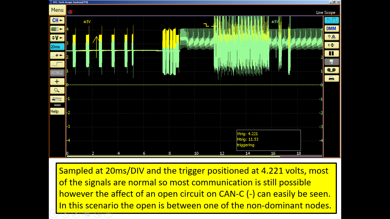

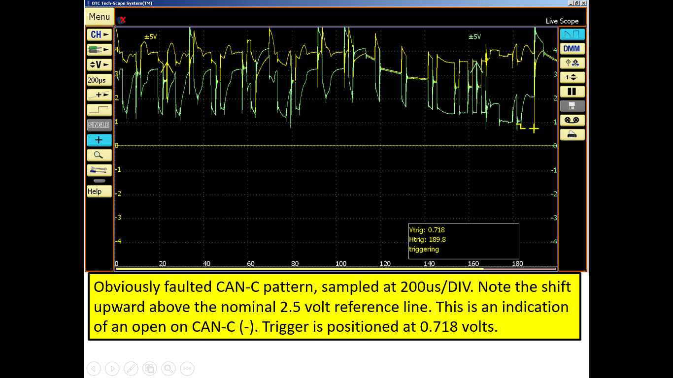

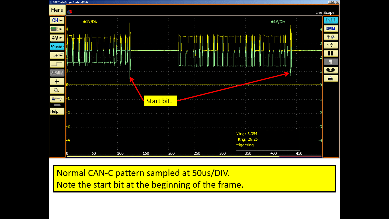

Hopefully this might help. I was working on a 2014 1500 yesterday that had similar symptoms, would not start on occasion. We finally caught it broken and wiTECH showed no VIN, and PCM was off line. We are thinking we have a n open or partial open on one of the CAN legs. Here are a couple of screen shots from a presentation we had in Detroit several years ago that shows normal and one leg open BUS messages.
Notice that the colors split right at the 2.5v line. That is because one leg is positive, the other is negative or mirror image.
This is a faulted signal with one leg dropping out. Notice how the colors are biased up past the 2.5v line. When one leg is open to a module the voltage gets "pulled" up because the voltage is slightly higher on one side of the BUS.
Here is another shot, you can clearly see the color shift of the traces are above the 2.5v line.
Thanks for the images.. I wasn't able to grab them from the O-scope I was using, though I did get a couple of printouts. I didn't see the faulted signal in your images, what I saw looked mostly normal, though I also have a 3rd trace that was the additon of CAN H and CAN L, and since they are supposed to be mirror images, in the opposite direction, the addition should yeild a straght line.. which is sort of was, but there were some spikes during transmission above and below in the addition line on the scope.

And just to clarify the can messages should be mirror image of each other for a good signal. There should be no stray tails and they shouldn't really be too fuzzy, assuming that you're oscilloscope is set correctly and isn't making it look fuzzy

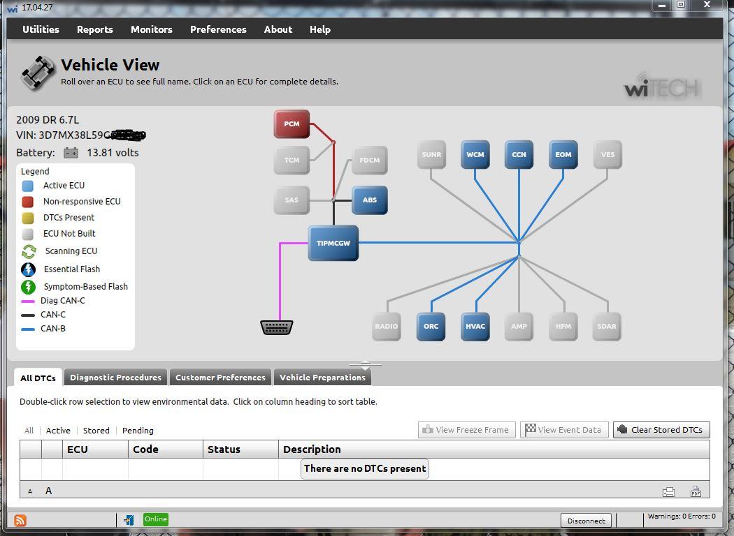

No network communication errors! Now the saga is not over yet, the proof will be several drive cycles and trips.. if the ECU stays in comms with the UG, I'll call it a complete success. If not, well I'm not really sure what it could possibly be.. hopefully I won't be going there!

Ok, ECU all programmed, Truck runs, no DTCs. Now it's time for a test drive. Seems the used ECU I got actually works. Also, when sorting service records, I came across the first indication of an issue with the original ECU, when the truck had barely 7000 miles! It was an implausible U1421 code that is applicable to an auto transmission truck. There other odd codes over the years, some U-codes. This is what led me to first suspect TIPM, but it now seems almost certain it was always comms problems from the ECU.

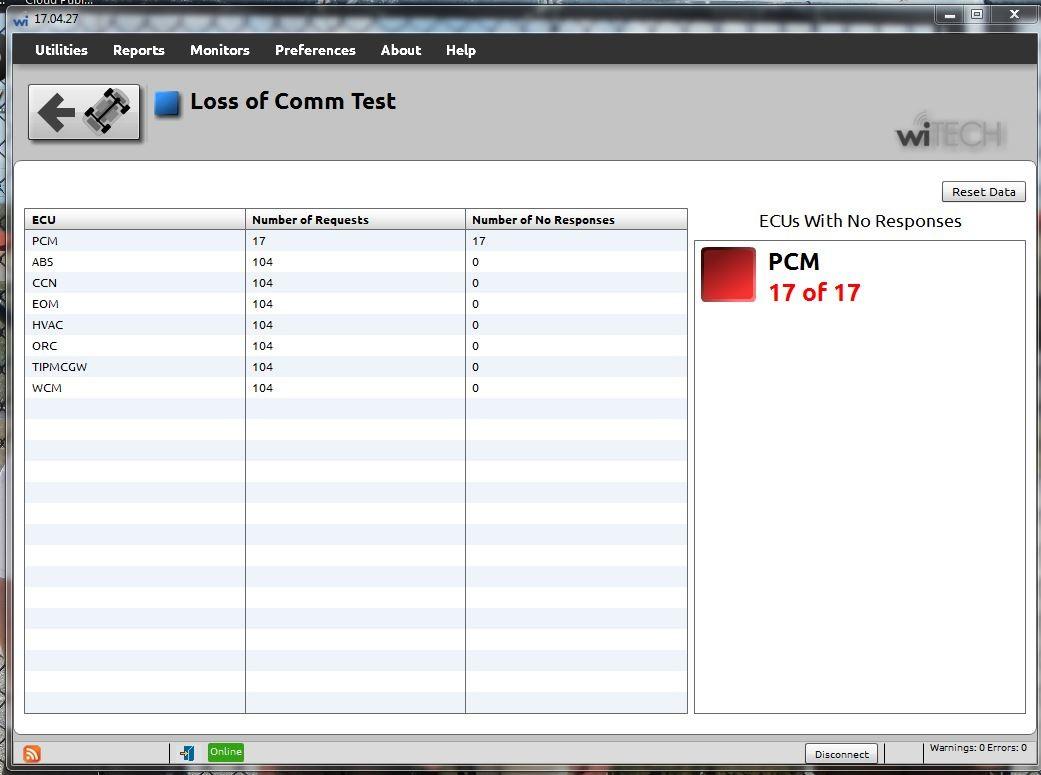

Too good to be true. While the replacement ECU seems fully functional.. I get the SAME issues that existed with the original. The ECU becomes non-responsive via the DLC/OBD2 connector. I just shut off at some random time after running for a time.. sometimes a short time, other times stays on for even a long drive.. just as it die before! I got only one stored DTC, from the WCM for loss of comms to the TIPM.. just as before.
I'm at a loss.. seems all that is left is some other module, but with CAN protocol that seems very unlikely. Could have have a second bad TIPM doing the same as the original? Seems the odds of that are super small. Could there be a wiring issue between the ECU and TIPM, perhaps.. but HOW DOES CRUISE control still work!! Seems that would need communications.. I don't have other modules saying no communication to ECU.. which SHOULD be there if the comms to ABS and other modules was cut off.. seems the only place comms are cut are the TIPM.. going right back to where all this began.
It's crazy, and I'm not sure what to do next, but at least I now have two fully functional ECUs, and I got the spare at a good price.. I guess that is a plus.. but I'm not sure what to do next.
