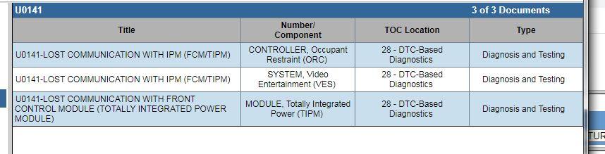

Now I did notice something odd, my WCM shows as "development" on the ECU details report, Im pretty sure it should say "production". Is it possible the WCM is causing an issue? That seems very far fetched, it's on the B CAN bus and connected to the ECU only via the TIPM that ties the networks together.
Digging into that U0141 code in the WCM.. there is not mention of that code for the WCM in the Mopar database!

OK, I have the service manual back up again, and going through it again looking closer at that U0141 that showed up multiple times in the WCM... For a stored code, it has you do basically look for CAN signal path in a non-specific way.. but for an active code it has you replacing the module that generated the code, in this case that code only appeared in the WCM. That bolsters my decision to replace it.
I also went down the non-responsive ECU thread, and it does not seem to fit the specific problems, it looks at signal path on the CAN C to TIPM, and power. Well if I had ECU power issues.... I'm quite sure I'd KNOW about it, and if the ECU to TIPM connection was a problem, the ABS would have the DTC for losing comms with the ECU, but that is not showing.. the issue is between the TIPM and DLC (Scan tool).
Also, the TIPM has a DTC for losing comms with the WCM, I have NOT seen that, only the WCM saying it can't see the TIPM.. and of course the odd "development" status of the WCM.
