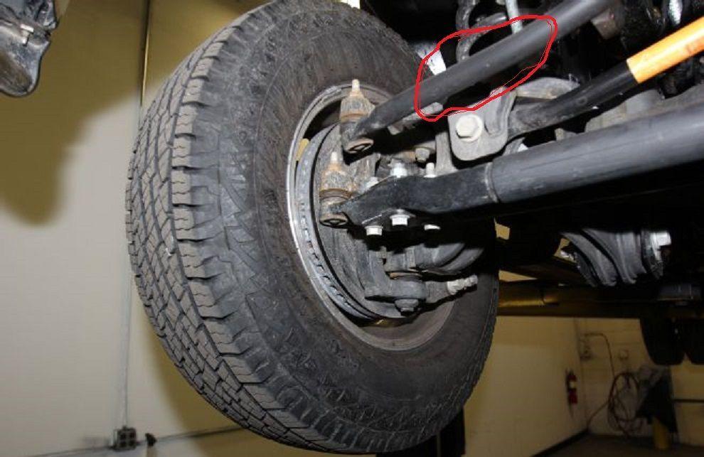

IMO, No-way is welding going to resolve the adjustments form coming loose (Unless), Stop typing and go to your vehicle and have someone turn hard right back and fourth, You will see the Steering arm / Drag link flex. If some practices daily turning hard right nothing other than welding both ends!!!!!! will stop it in the extremely rare case it loosens.
The adjustment is for steering wheel centering I like my steering wheel centered and it should never need to be adjusted, but even the most remote possibility I like the option to adjust , That's why I want the service agreement form FCA, if in the future it needs adjusting they FCA will need to replace it.
IMO in the end FCA will fab up two locking sleeves attach to locking bracket.
Something like this..........

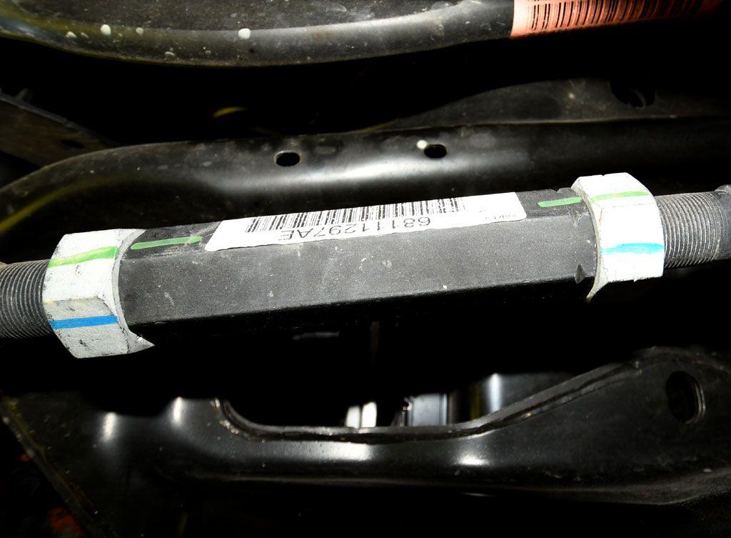

I called another dealer this morning. They said 2 hrs to check, 2 hours if needs fixed. I checked the drag link. See pix. The nuts were tight and the blue and green marks are either factory or added when I had the 12,000 mile (free LOL) oil change done. I think my best strategy is to just watch during self service.

I agree - NOT welding on my truck. On older trucks I adjusted that almost every alignment.
Since the recall states "If the torque values do not meet requirement, the drag link...." Why not just loosen the nuts before you bring it in - they were NOT tight and the whole thing should be replaced.
So if they replace the parts will they still weld all the new parts up?
