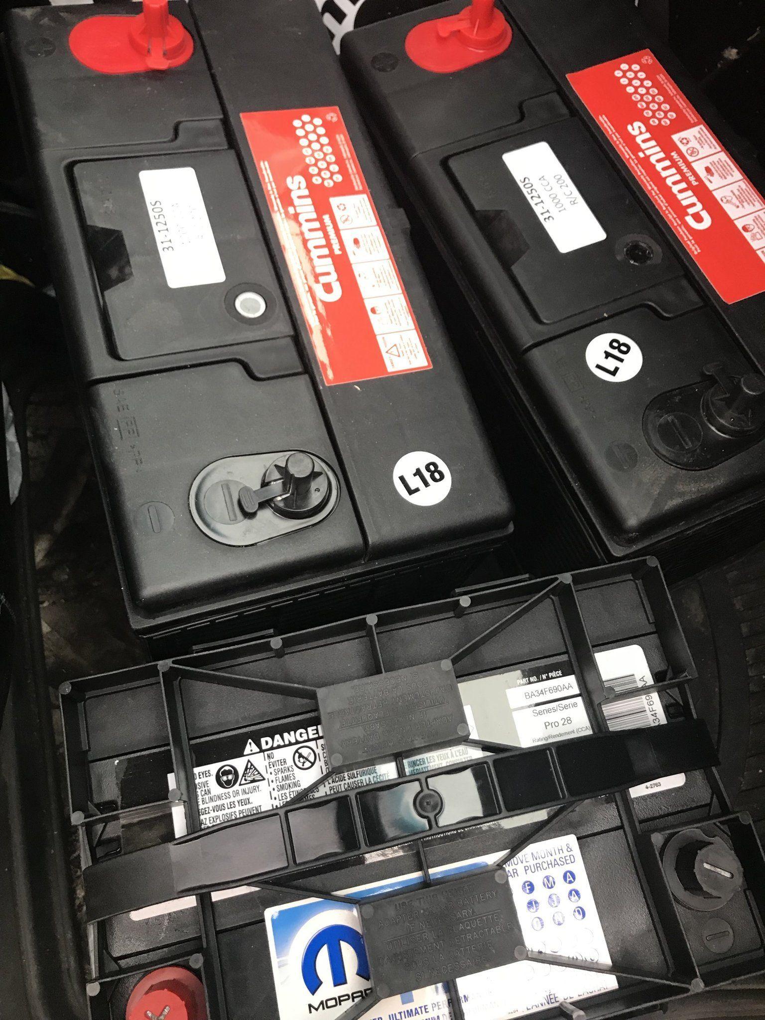

Cummingz batteries, have to be better than anything out there :rolleyes:
CAT batteries are excellent, and like batteries made by East Penn, these Cummins batteries should be good too, I believe they're made by JM, correct.
You can get them from Onan, Peterbilt or any Cummins Generator dealer.
