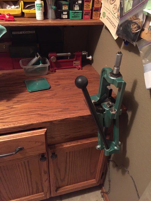

I built a cabinet, then used a piece of oak-over for a top surface. I wish I used a laminate top because the wood surface is a terrible writing surface. The cabinet underneath is a little uncomfortable to sit at, but I store my scales, cleaned shells, tools, etc etc down there. Keeps the dust off most of it. The spacer under the press is to clear the swing of the doors on the cabinet.
