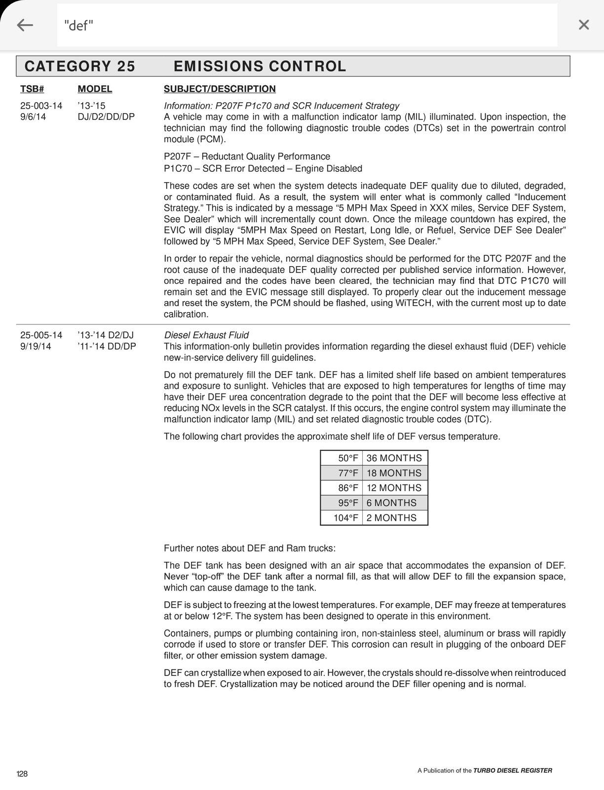

There are a few TSB on this topic, not sure if they apply.

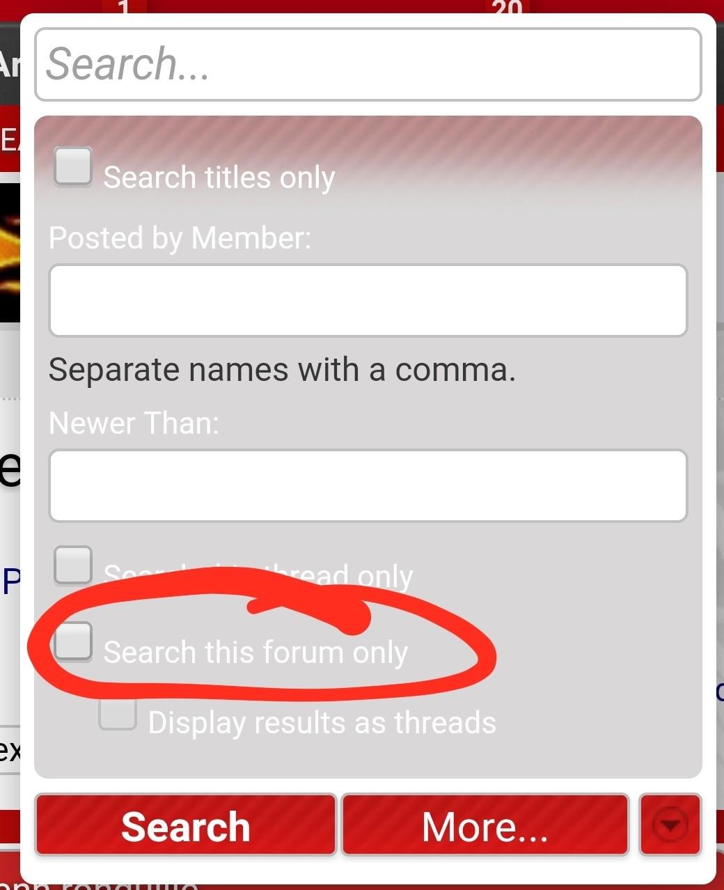

When you search make sure the search thos forum only is NOT checked. It sometimes auto checks on my phone.
User TCDiesel has a lot of posts about this topic, so you could search DEF then add user TCDiesel.
